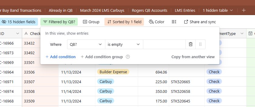

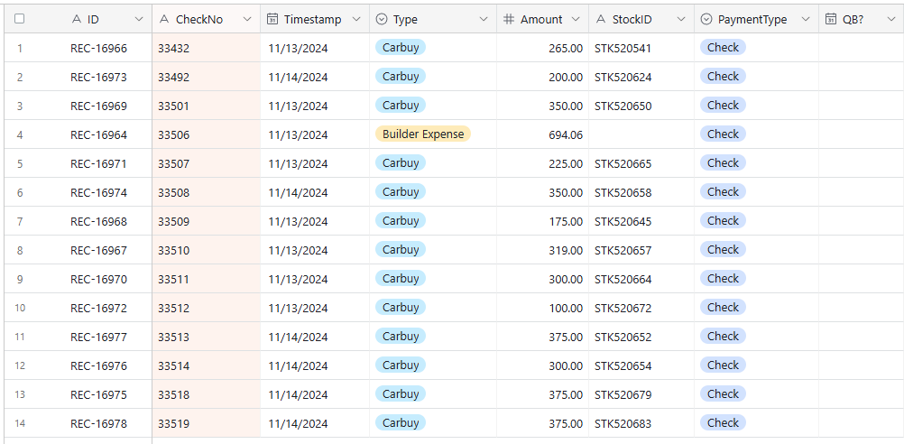

Hope that makes sense.  I have two attachments. One a screenshot of the found record set.  Notice that the QB? field is empty. That is the field that needs a date to take it off the filtered group.  I also attached the filter setup.

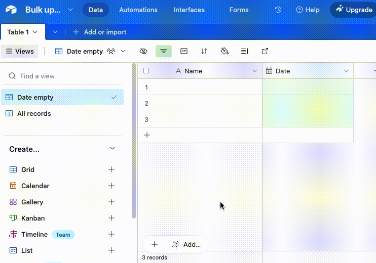

Hm, try:
1. Click one of the cells in "QB"
2. Key in a date
3. Hit CTRL/CMD+C
4. Click on the field header (That record should now filter out)
5. Hit CTRL/CMD+V

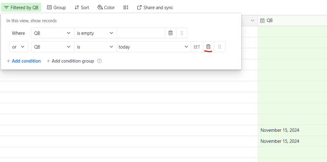

adjust filter, copy-paste date to the whole field, click thrash can to return previous filter state (and see all records are filtered out)
