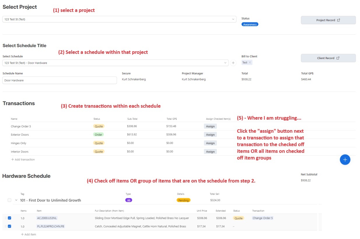

Looking to use a button that when clicked, links that associated record to other selected records.

Well though out and appreciated!
Unfortunately won't be able to make that solution work.  Firs the number of TRANSACTIONS per SCHEDULE will vary, and second there may be users doing the same workflow in different projects at the same time.
