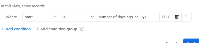

So, to be clear, your suggesting having the daily schedule to check the date each time?  I had 2 posts, and I'm assuming you're replying to the 2nd one.   Thanks.
No, the trigger will be 'When a record enters view'
A view filtered like this
or you can add formula field 'Notification date' DATEADD({Field}, 3 'months')
and filter view as 'When Notification Date is today'
trigger will be based on a view.
after whole setup, I would recommend to lock a view. someone playing filters can accidentally make an effect of 'unfilter all', just for a second. That's enough to run in for every record entered view, means for all records in table

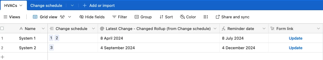

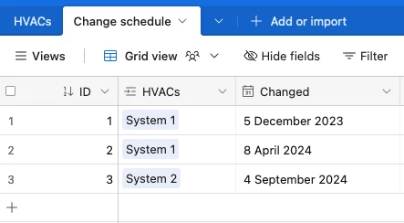

Yeap you could, but how you set it up may vary.  Here's how I'd handle it.
You'd have a table which logged each change for each HVAC:
Which would allow you to rollup the latest change date for each system with "MAX(values)", and have a formula field add 3 months to that for the reminder date, and you could trigger an automation by having the condition "Reminder date = Today" to send out an email:
I'd also set it up so that the email sent out a prefilled form link so that she could fill it out too, and the "Update" button provides an example of that
https://airtable.com/appajHSGfgMyYVQaW/shrQ8pXwWYj0TE7IV?prefill_HVACs=recPLfiMTwkOYG2hM
This way she'd just click the link and key in the date without needing to select the HVAC that she's being emailed about
Link to base
Nope, I was replying to your first post, sorry for the confusion!  The setup I built it doesn't use a daily scheduled automation
