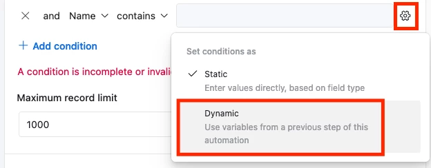

I'm trying to create an automation with these conditions:
  • First and last name match
  • Original entry with matching name was created within 90 days ago
When I try to use when a record matches conditions trigger, it does not let me select a dynamic variable so I'm kind of lost on how to move forward with this so any help would be appreciated.

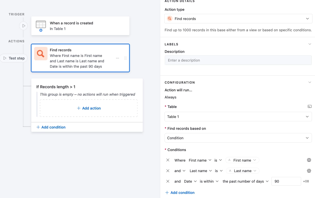

One way to solve this:
  1. Create a helper field that is a formula to compare if the names match
  2. Create a helper field to determine the days since the record was created
  3. Create a formula field to see if the names matched and the number of days is > 90 (1 and 2)
  4. Create your automation to look at the formula created in 3
You can see this as an example here
Hmm does this look right?
Link to base
Not too sure what you mean when you say you can't add a dynamic variable?  After we hit the gear icon and select 'Dyanmic', then the triggering record's data can be used in the automation if that helps
