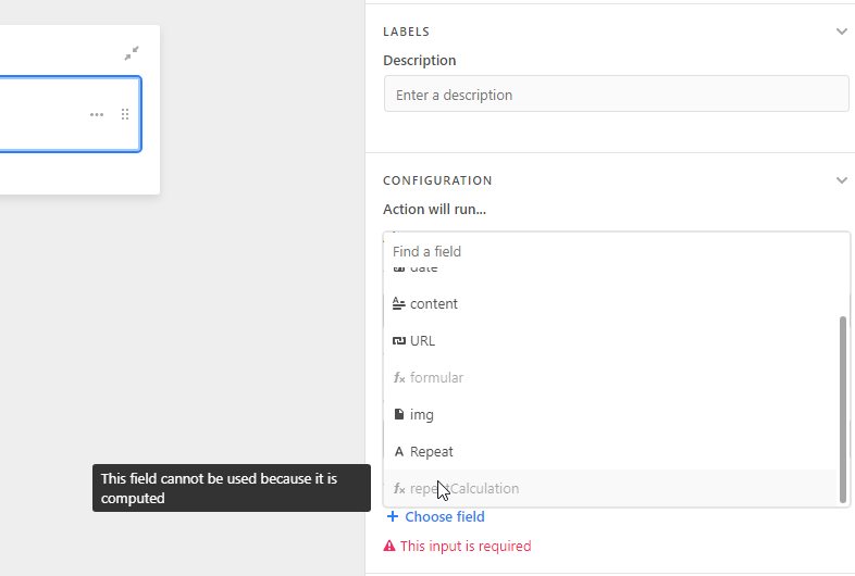

When chosing Field i can not select my [RepeatCalculation]Formula.
  • The following error message appears
I think I have missed something. I am grateful for any help.

Hi Boris, I’m not too sure why that’s happening. I’ve set up a base here with the automation you’re trying to do and it seems to work fine. Perhaps you can compare the two to see what the differences are

Hi Adam, Thank you very much for taking the time to look into my question. The example you created helped me a lot. I have made a mistake with the RecordID. Thanks much for sharing your insight.
