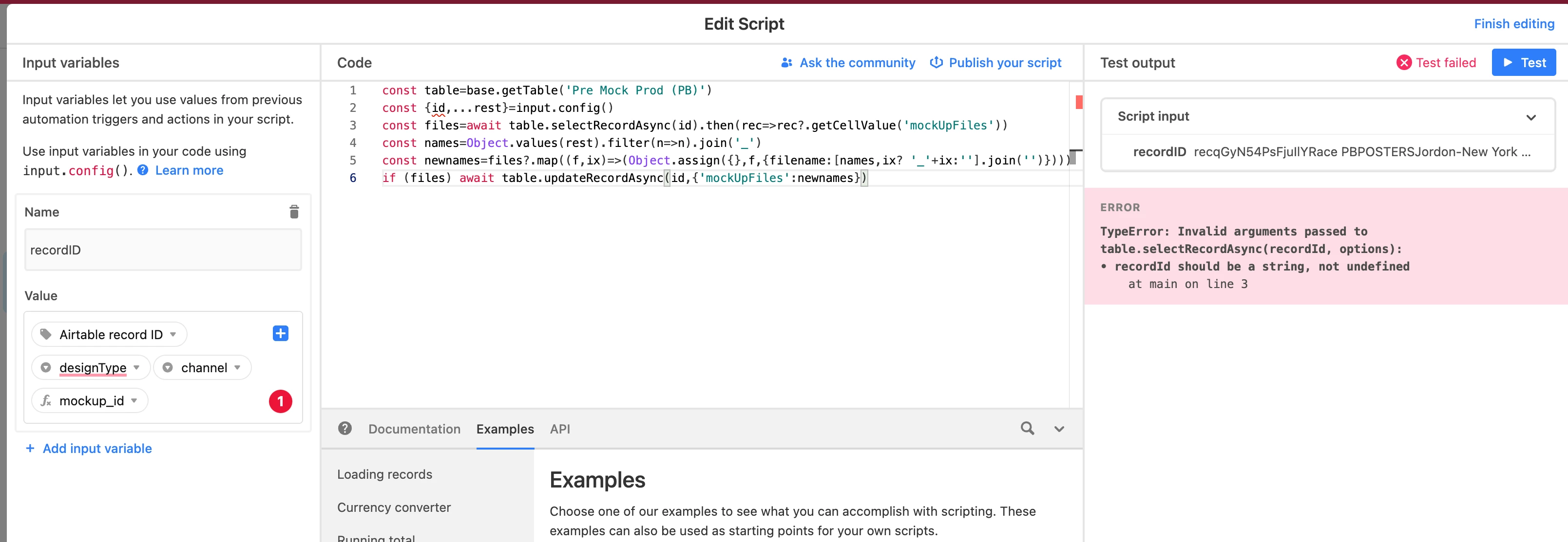

Hey Alexey, thanks so much for taking the time to rewrite this. However, I am getting an error when I run this - I'm sure I am missing something obvious...this is the error:
TypeError: Invalid arguments passed to table.selectRecordAsync(recordId, options): • recordId should be a string, not undefined at main on line 3

you should give first variable the same name, as it written in code. so, change 'recordID' to 'id' on the left side.
also, you are put all 4 values into the same variable, while you need to create separate variable for each

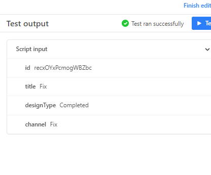

also check the right panel, after script run it should display input parameters like this (of course values are random data):
and by way, it doesn't matter how you will call them and how many - they all (except id) assigned to a variable rest and then joined into a string with given delimiter.
