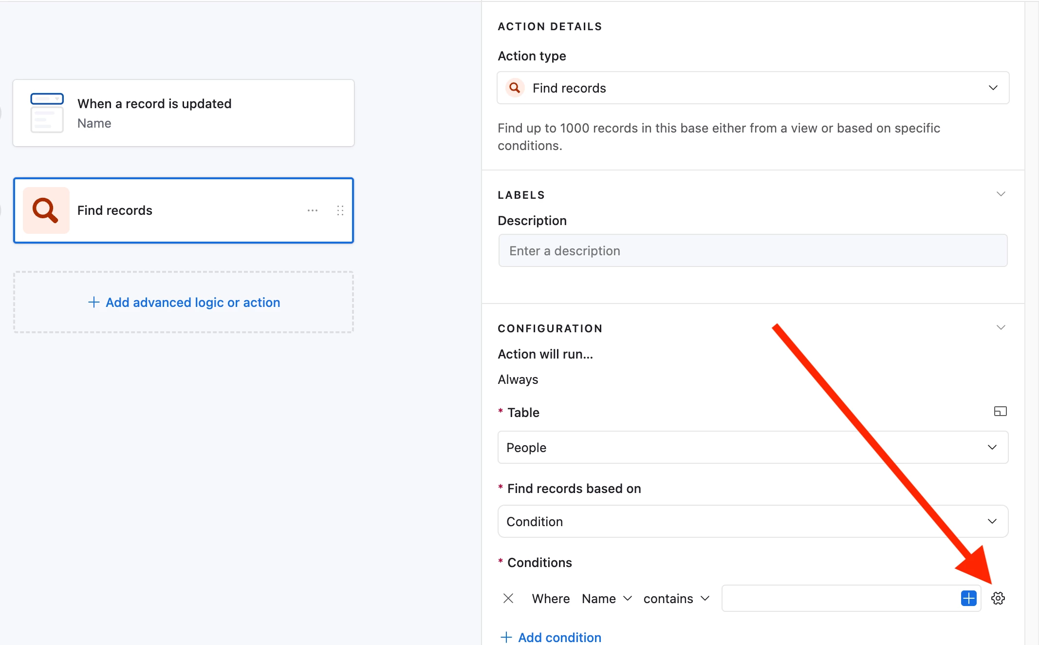

Best answer by ScottWorld
Yes, you can find the record that triggered the automation.
Additionally, you can always pull in the field values from the triggering record as well.
But I think what you’re missing is the tiny little gear icon all the way to the right of your conditions, which lets you setup a dynamic find action.
Check out my screenshot below for where you can find this.
Hope this helps!

  • May 11, 2025 11:03 PM UTC
Hope this helps!
Forum|alt.badge.img+15
  • May 11, 2025 11:52 PM UTC
Ah! Total brain blank, thank you this should work! I’m not 100% of the sequence of actions that leads to this issue (its a less than once per week thing), but hopefully this resolves it :)
