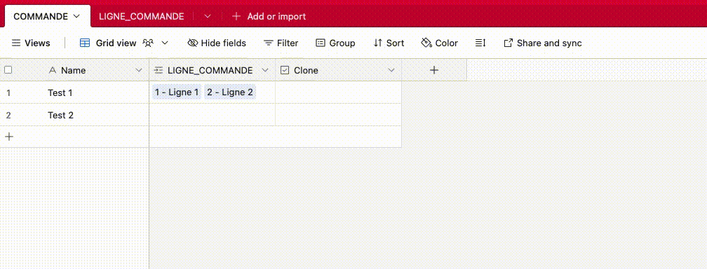

Hello,
I am pulling out the few hairs I have left over a problem that I am about to solve, but I can’t find the sticking point. To summarize:
I have a record in a COMMANDE table, linked to multiple records in a LIGNE_COMMANDE table. (The classic case of an order header with its order lines).
I want to be able to “Clone” via automation (when a record enters a specific view, for example) both the information contained in the COMMANDE table and the content of the linked records in the LIGNE_COMMANDE table.
When I say clone, I mean creating a new COMMANDE record (almost identical, as it will have a new order number assigned) and creating new linked LIGNE_COMMANDE records (identical but linked to this newly created COMMANDE record).

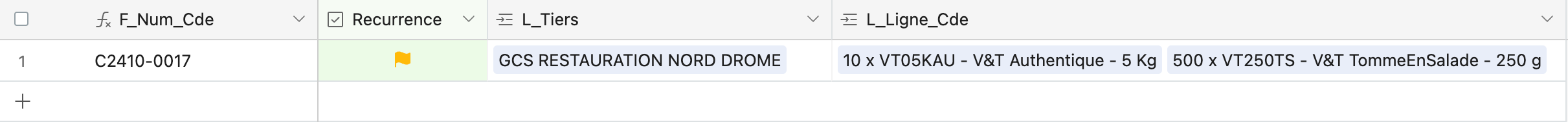

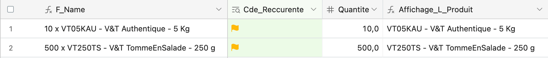

Bonjour,
Voici l'enregistrement à cloner (Création d'un nouvel enregistrement à l'identique) :
Et voici les lignes de commandes (L_Ligne_Cde) à cloner également à l'identique et à relier au nouvel enregistrement créé précédemment :
Merci beaucoup !

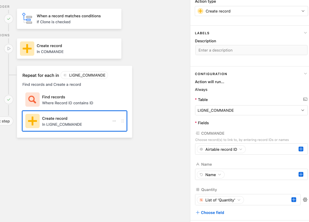

Hmm perhaps try setting up your automation like this:
So it'll create the COMMANDE record, then will create one record for each of the linked LIGNE_COMMANDE records.  It also populates those LIGNE_COMMANDE records by grabbing their data via Find Record action

Merci pour votre retour.
Je vais pouvoir avancer néanmoins j'ai cette erreur :
Creating the record failed due to insufficient permissions.

Pourrais-je avoir un accès complet à votre solution ? (Je n'ai qu'un accès en lecture seule)
Yeap definitely!  Try duplicating the base into your own workspace!
https://support.airtable.com/docs/creating-a-new-empty-base#duplicating-airtable-bases
