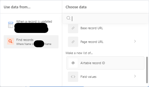

Update: I might  have found a workaround/solution:
  • Trigger: When any relevant value on Table A is updated,
  • Action:
    • Find record on Table C that matches with the common value between Tables A and C
    • Update record, Using the record ID as what's suggested under the Find Records option:
    • Map the values accordingly.
Then, I just duplicated the automation for table B and adjusted the mapping.
Most of my test updates worked and I got a few errors that I'm working on but seems to be a -so far- good way to go about this. I'm leaving this on in case someone else got something else to share!
