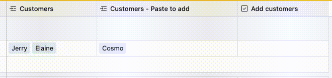

As a workaround, what if you tried creating another link to customers, pasting it in there, then having an automation merge it together?  I’ve set it up here for you to check out

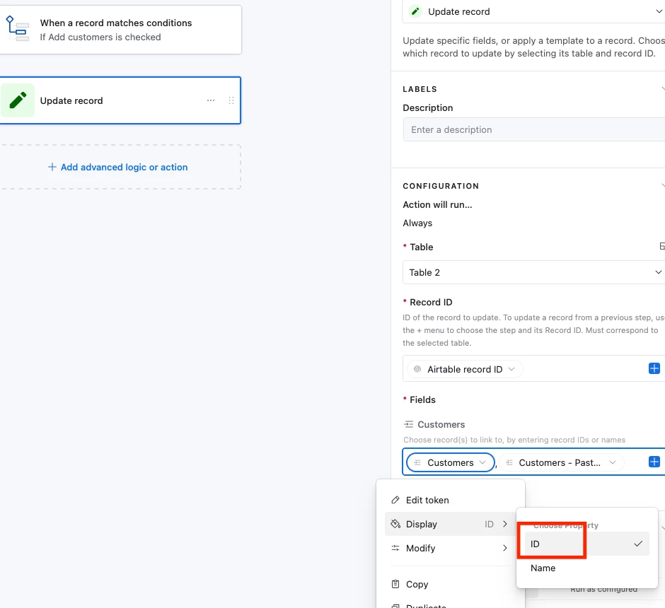

And here’s how the automation looks:
The idea is to update the ‘Customers’ field with the combined values of both linked fields while separating them with a comma.  I’d also recommend using the ID value as well as that will save you some headaches in case there are customers with the same primary field value

Thanks a lot TimeSavingCo, that works !
