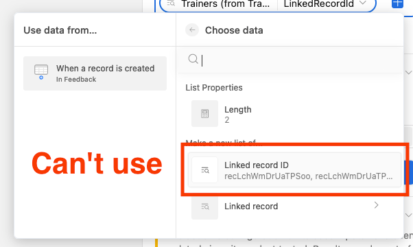

Sigh yeah, it's a weird one.  You can't use the initial IDs it gives you in the lookup:

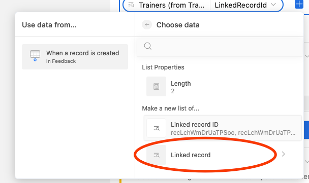

You have to click in to "Linked record" and then use the "ID" there:

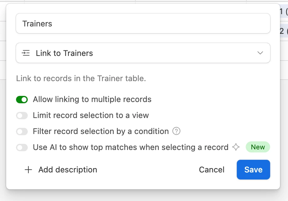

1. Make sure you "Allow linking to multiple records" in the Trainer field

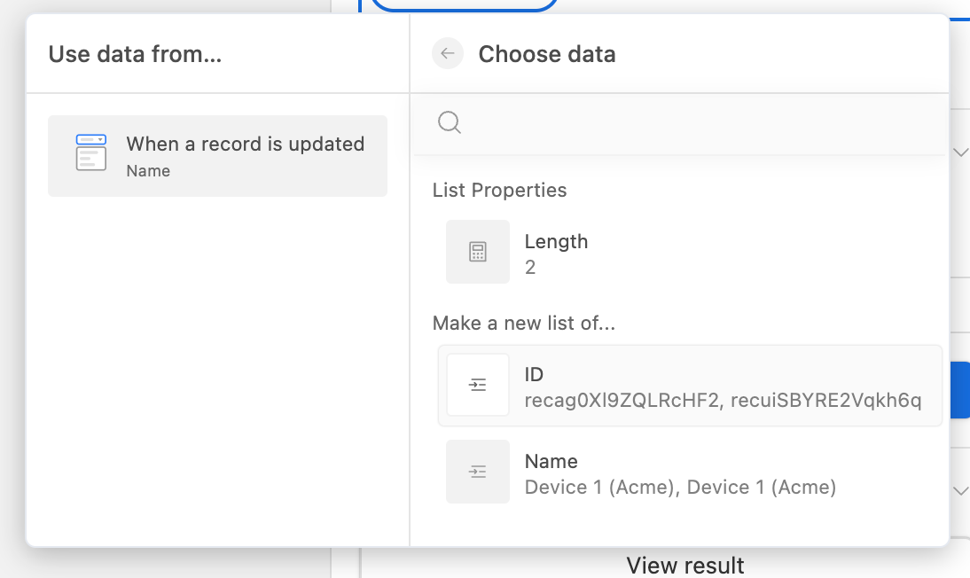

2. In the update record action, make sure is a list of ID's.

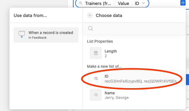

If the trainers come from a field, should look like this

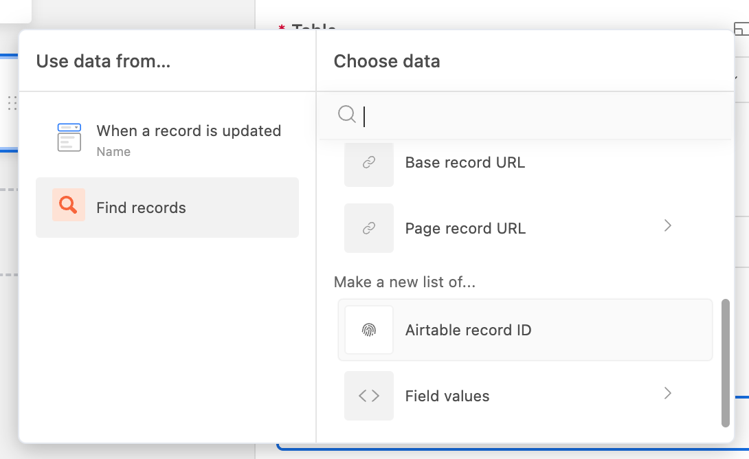

If the trainers is using Find Records
