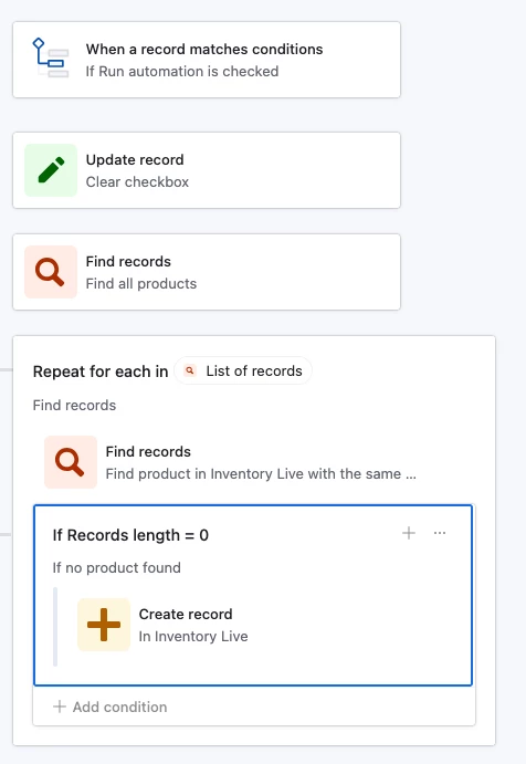

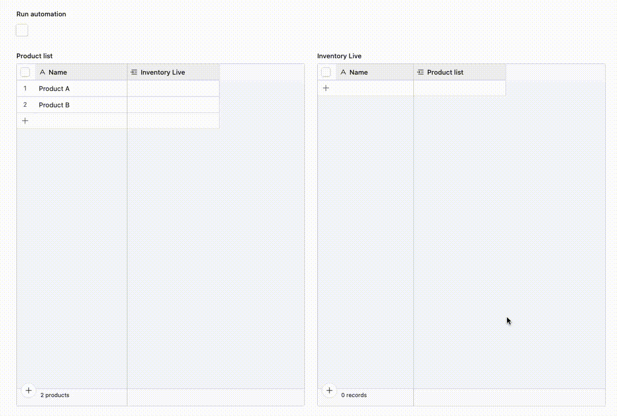

For tables,  you can do this with a scheduled automation with a Repeating Group and a Conditional.  I’ve set it up here for you to check out
And here’s how the automation looks.  The idea is to:
  1. Use a ‘Find record’ to get all the products from the Product List table
  2. Use a ‘Repeating Group’ on the found records
    1. For each of these records, use a ‘Find record’ step to see if it exists in ‘Inventory Live’
    2. If it doesn’t exist, create it
And you’d just duplicate this for each table you wanted
