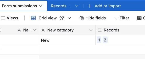

Assuming your base looks like this:

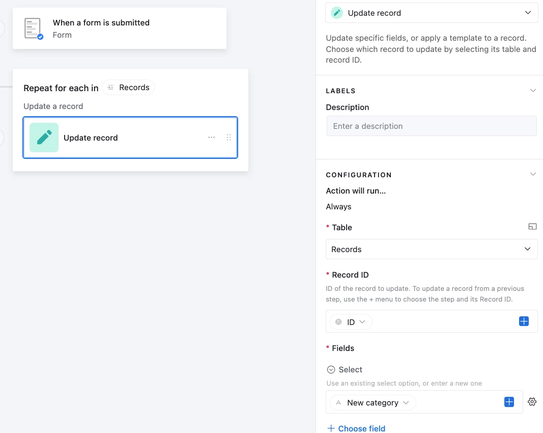

Then you could set up an automation like so:
It takes all of the records the user selected and uses them in a repeating group, and for each of the selected records it pastes the value from the text field 'New category' into the 'Select' field, which creates a new select option and applies it

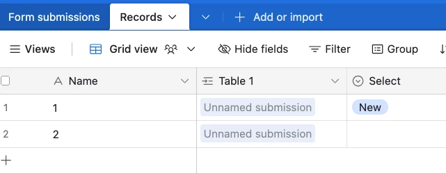

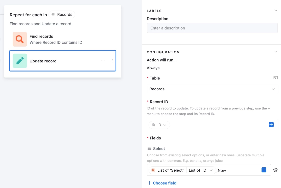

Hmm, if you're okay with the possibility of a blank option like so:
Then you could set up your automation like this:
Getting rid of the blank option's possible, but would require a small script.  Lemme know if that's something you'd like and I'll see what I can do!
