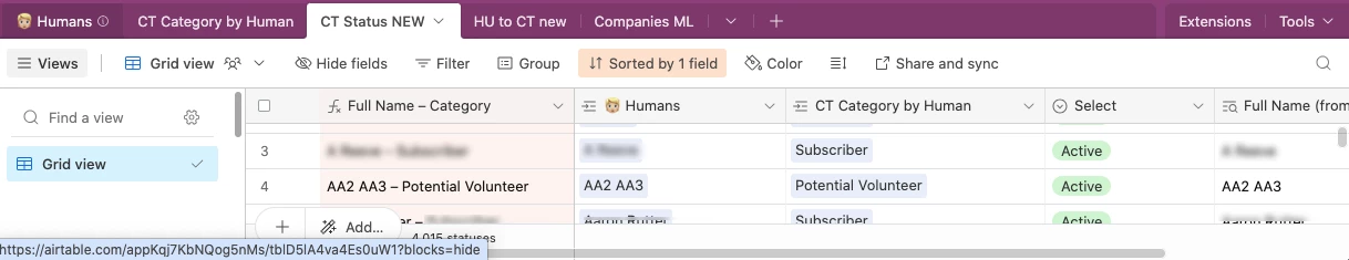

Okay.. so... bear with me... I have people that have multiple roles {Contact Type} in the company (Humans Table)

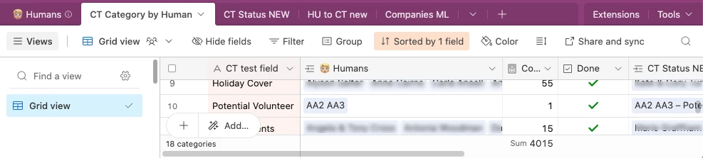

I also have a Junction table (CT Category by Human) so I can manipulate the data
so in my third table (CT status NEW) now that each role {Contact Type} is on a separate row I can add a different 'Status' to each role

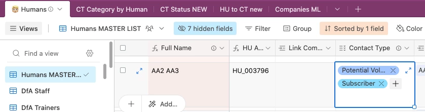

My issue arises when I add a new role to a contact in the 'Humans' Table. I have a working automation that populates the Contact Type row in the junction table with the new human that has been assigned this role....

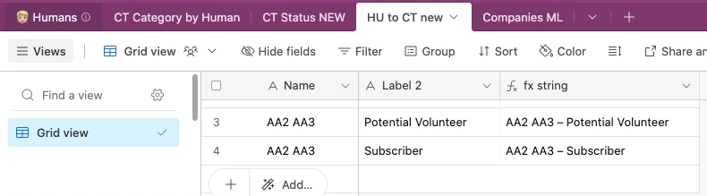

But I can't work out how to get that new info into a new row in the third table in order to allocate a status for it.... What I have been able to do is create a fourth table that creates records anytime the [Contact Type] field is updated in the first table... like so..  mainly so i can keep track of how often role changes happen. Table names 'HU to CT new':
I'm hoping i haven't lost anyone so far... so currently AA2 AA3 human is a Potential Volunteer, but he has just signed up to be a Subscriber too.  I already have a record in my 'CT Status NEW' table showing this, but I need to run an automation that says if a new record has been created in table 'HU to CT new' can it check in the 'CT Status NEW' table that if it's not there to create a new record.  I have matched the fields so the find value should be the 'fx string' formula in the 'HU to CT new' table as that mirrors the primary field in the CT Status New table.

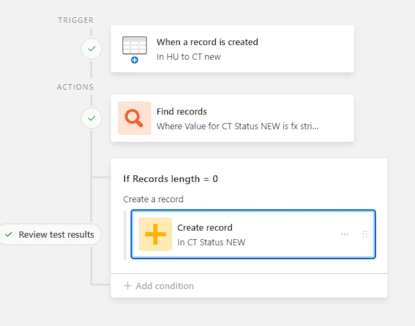

I managed to find a Solution!!:
1.There are no changes to any of the fields or tables in the base mentioned in the original message.
2. Automation is as follows:
