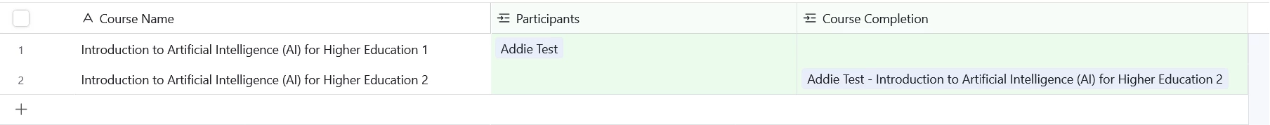

What is happening is that the new record will do one of three things: it will link to the correct record in the course list, it will link to a different record in the course list, or it will create a new record in the course list. I actually need to make some changes to accommodate users who get future enrollments, but I want to get this working first.

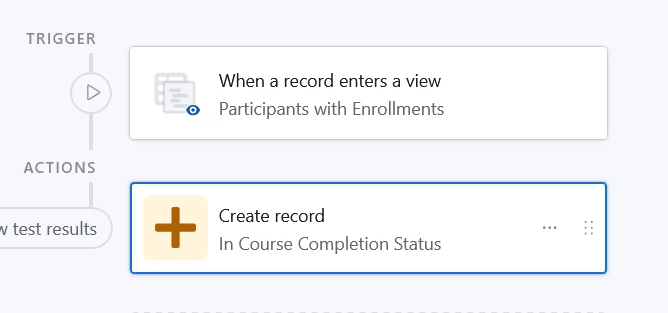

Here is the automation setup:
When record enters a view in Participants table, create record in Course Completion Status table. The view is set to show only records in the Participants table where the Courses field is not empty.

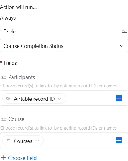

And the action settings:
Course Completion Status table, fields: participants linked field with Airtable record ID selected, Course linked field with courses record selected.
Here is what it looks like from the various tables:
Partipcant table
Course List table
Course Completion table
ETA: what I want it to do is if I add a participant to the AI course 1 it will create a record in course completion linking it to the course 1, not course 2. The participants table has linked record fields to both course list and course completion. course list table has linked fields to participants and course completion. course completion table has linked fields to participants and course list. They all are linked together so I’m not sure why it’s misinterpreting or how it’s even grabbing something else.
