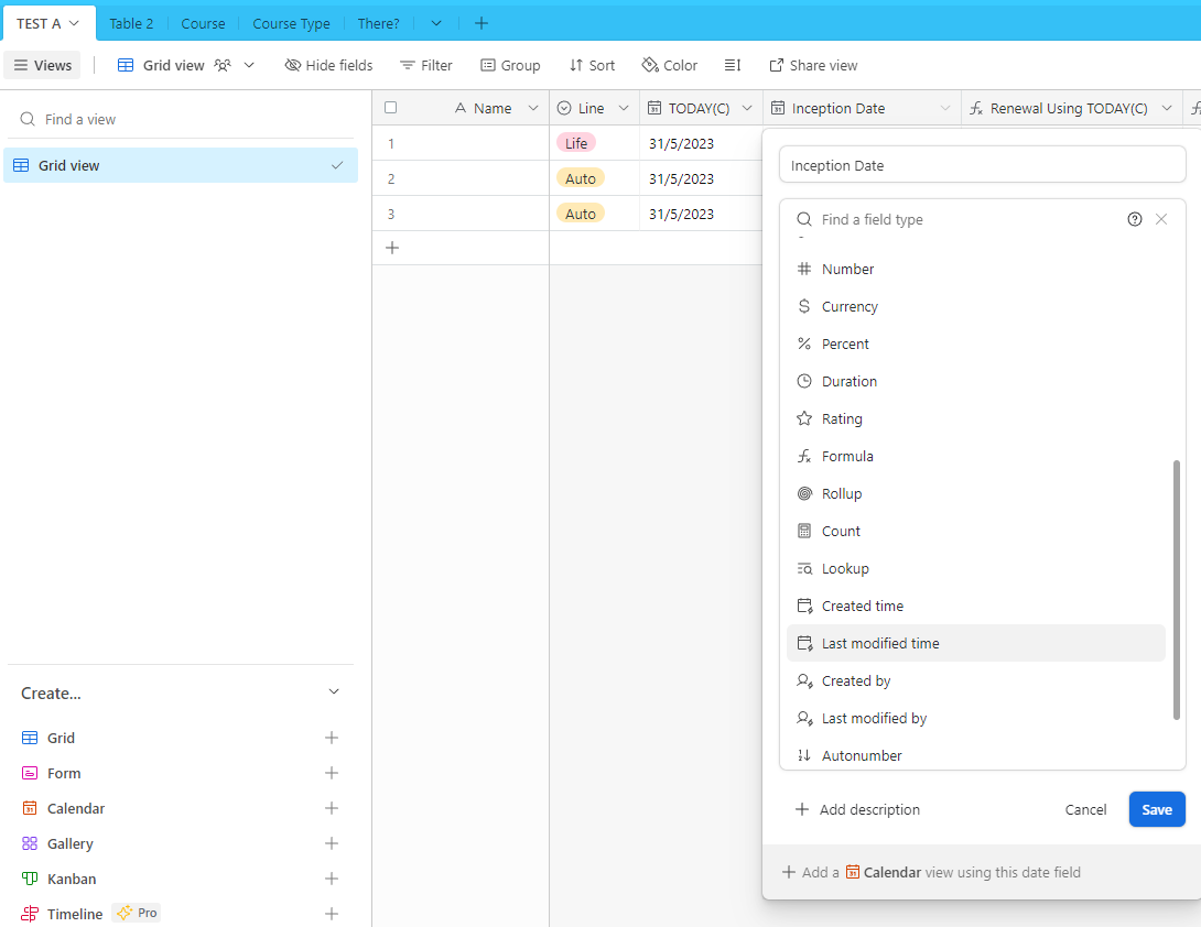

That does sound like it's exactly what I'm looking for - however, I can't seem to find this option... is it accessible through the blue "plus sign" button? If so, I must have some setting wrong that doesn't allow me to choose it as an option.
Forum|alt.badge.img+7
  • May 9, 2023
@DZaunLM This is a type of field type, it is not part of automations.  You create the field within the table itself.  Below you can see the option within the Field type selection drop down.
You can also read about that field type here:  https://support.airtable.com/docs/last-modified-time-field
