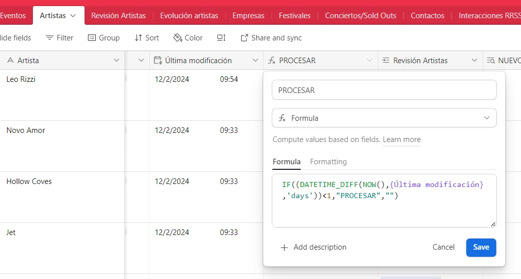

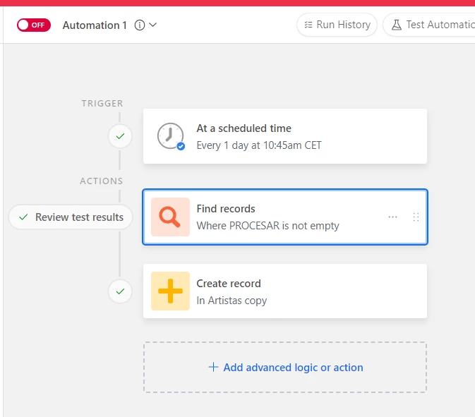

Hello Dan_Montoya, and thank you very much for your response. Do you have any suggestions on how to apply it? Following your advice, I have incorporated a formula that adds the text "PROCESS" to the artists I have reviewed in the last 24 hours.
Then in the automation, I add a first step to run an automation every 24 hours, and then I include a filter to select only those artists with the "PROCESS" label.

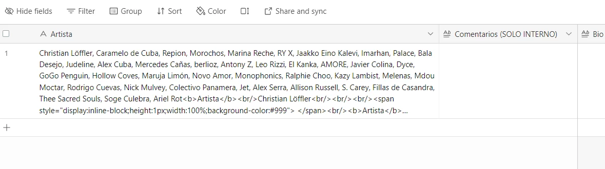

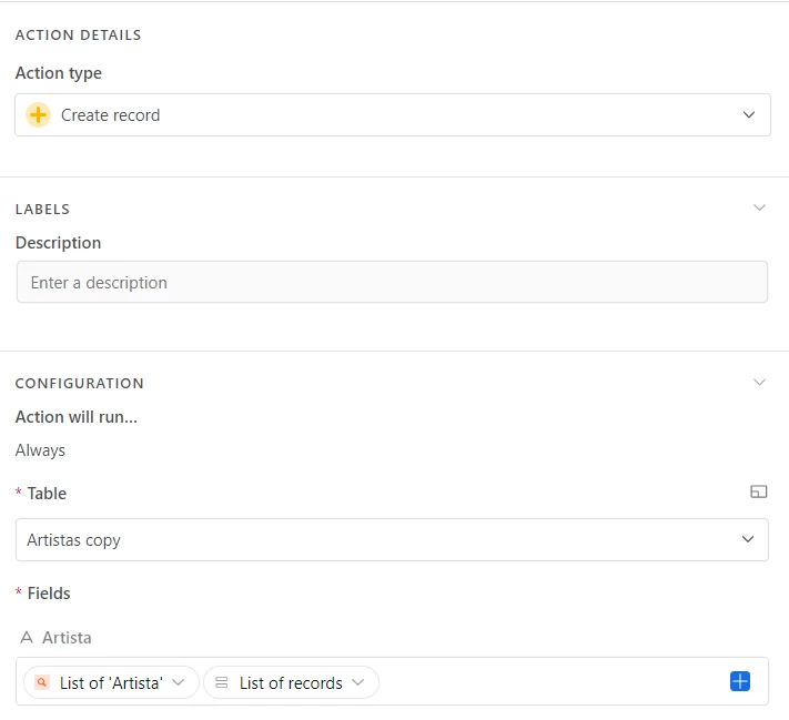

So far, so good, but in the last step of the automation, when I ask it to generate entries in the new tracking table, I can't get it to do it with one line for each artist. It writes them all together, separated by commas, on the same line.
Any suggestions to solve this?

The reason all of the artists are showing up in 1 record is probably because you are creating the record with the list of recordIDs found in your 'where PROCESAR is not empty'.
Problem:  the find will only return 100 records.  So when you change more than 100 artists, your find approach will not process 101, 102, etc.
I would use a new field to track hours since change. Then create a view that is filtered where hours since change is > 23 and PROCESS is set.  Then change your automation to be triggered by when the record enters the view create the record in table 2.  This will process all of the records that are changed regardless of more or less than 100.
