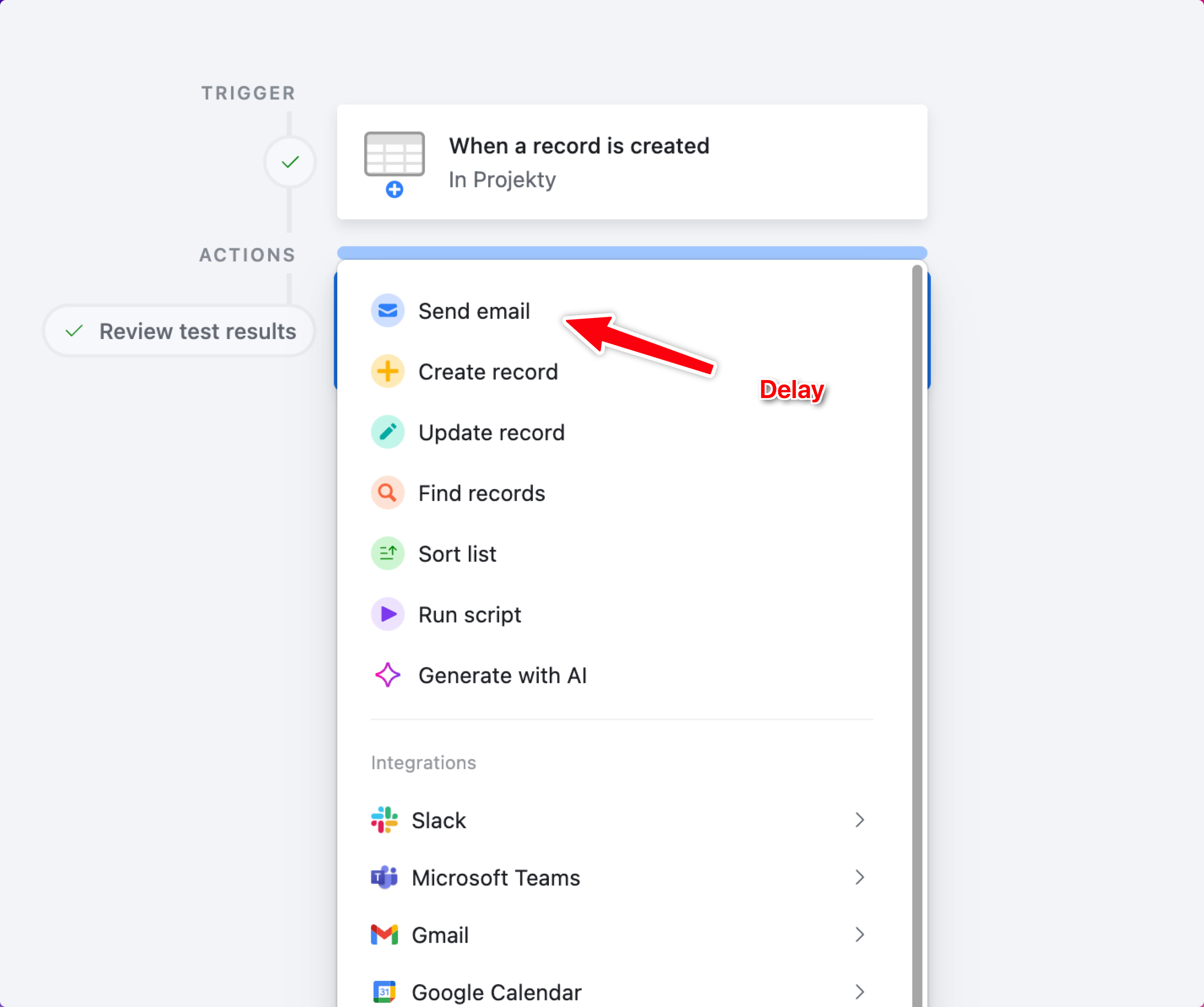

  • Feb 8, 2025 8:01 AM UTC
And just think, all it would take is one simple function between, for example, "When a record is created" to add a "Delay" option symbolized by a clock, and then "Send email". And all our problems with sending delayed messages or SMS would be solved.
1. When a record is created
2. Delay (for example 10 minutes)
3. Send email / run script / Twilio
