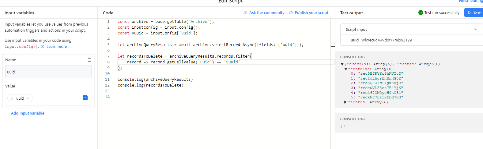

TIA for any assistance.
I have table1 (vuln) and table2 (archive).  I have an automation that when the record is created a UUID is created in the vuln table.  Then, when the status field of a record in vuln is changed form "new" to "closed" it creates a copy of that record in the archive table.
What I need is another script that does the opposite.  When the status field of a record in vuln is changed from "closed" to anything else (basically re-opened) it needs to find the record in archive based on the UUID field and delete the copy of that record from the archive table.  I have the trigger setup, but I can't get the script to return the record.
It returns the query, but the filter does not seem to work.

Here is what i am using for testing:
const archive = base.getTable("Archive");
const inputConfig = input.config();
const vuuid = inputConfig['uuid'];
let archiveQueryResults = await archive.selectRecordsAsync({fields: ['uuid']});
let recordsToDelete = archiveQueryResults.records.filter(
    record => record.getCellValue('uuid') == 'vuuid'
console.log(archiveQueryResults)
console.log(recordsToDelete)

Hey noob,
Could you try removing the single quotes around 'vuuid'? that might be causing it to compare to the string literal instead of the value.

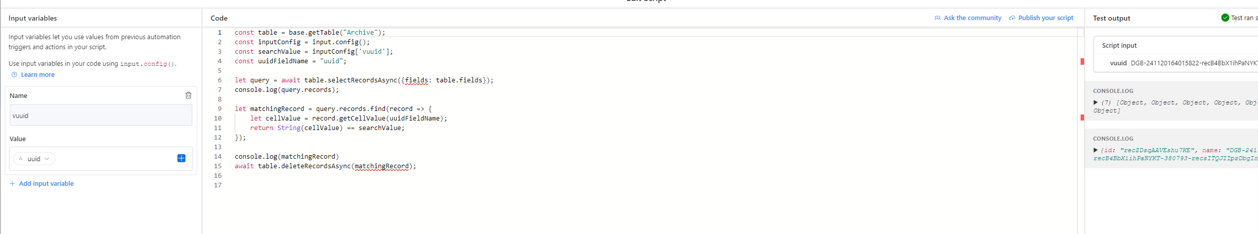

That would be easier, but ...  I need the user to be able to re-open or unwork an item for 7 days.
  • November 20, 2024
Hey noob,
I refactored accordingly and now it works!!  Thank you.
