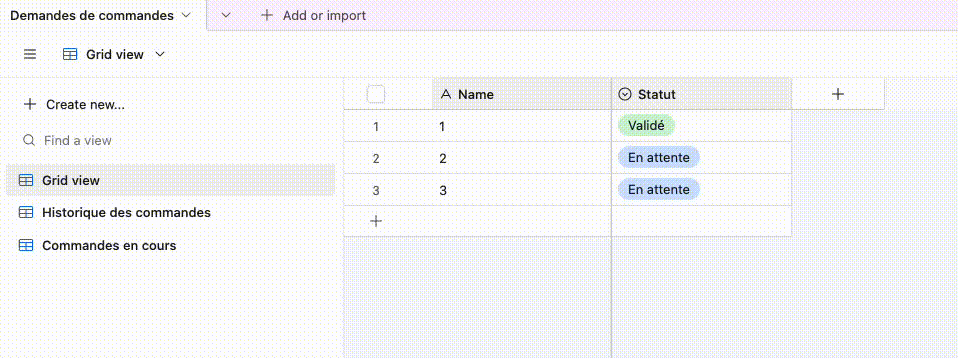

May I know why we want to have Demandes de commandes and Historique des commandes?  If we can handle the status of the request in Demandes de commandes via a ‘Status’ select field it’d simplify the workflow a lot

Hm yeah then I think you could consider using one table instead?  You could create views that filter based off of ‘Statut’ being ‘Validated’, and that way you’re not looking at anything that’s already completed, does that make sense?

I’m thinking of something like this:
This way you wouldn’t need another table to contain the past requests and would be able to work comfortably by only looking at current requests
