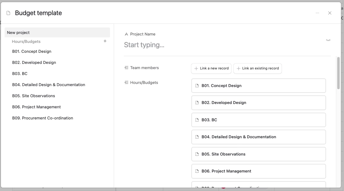

For this problem, I’ll show you how to do it with record templates. This will allow you to add those 9 phases to a project with three clicks.
First, it looks like your structure is something like this:
Where your project is linked to 9 budgets.
To set it up the record template:

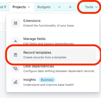

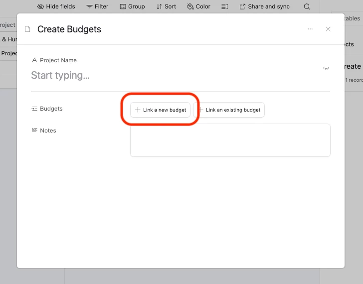

Step 1) Create a new record template. Go to the tools section and click record template. You want to create it for your Project table.

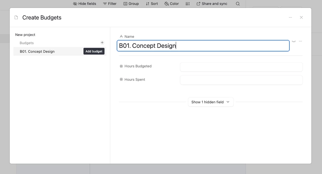

Step 2) You want to create and name all 9 of your budget phases
Click “Link a new budget”
Then, just put in the name. To add your second budget click the “+” on the left.
Once you’ve done that for all 9 phases, you’re ready to apply the template.

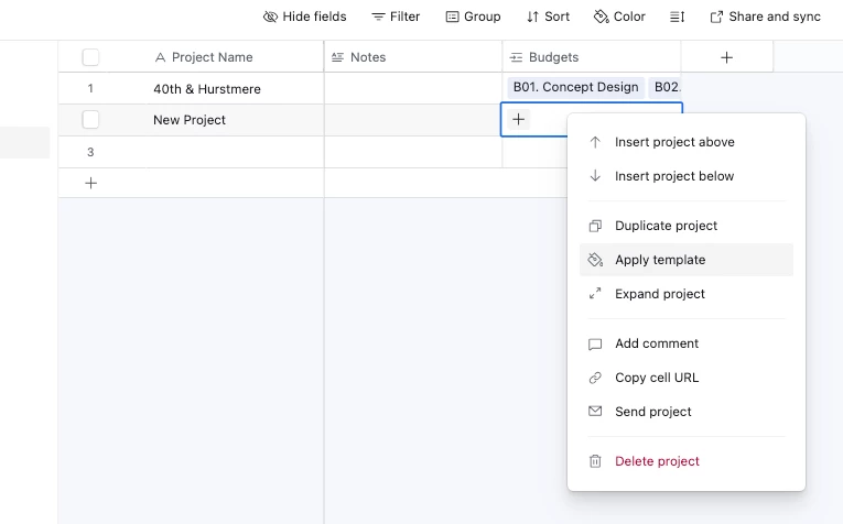

To use the record template, you just left click on your new project, click “Apply template”, then select the template that you just created.
Please ask any questions if you get stuck.

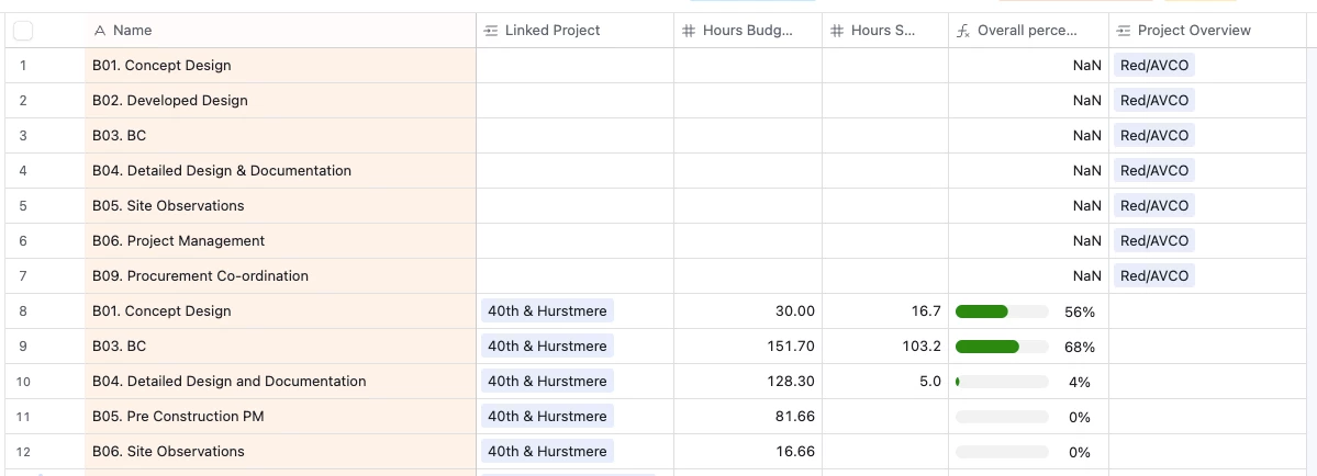

BuildForAT, i ended up using your method as a first try as it seemed th most simple! Thanks for the step by step. I can see when i have applied that template is carries over to my budget table whihc is great - but it doesnt link to the project so it pulls through empty. I thought it would automatically assign the linked project as it’s in that line but it hasn’t. Is there a way to do that?

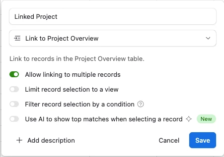

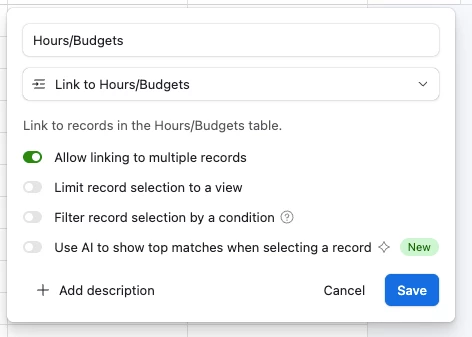

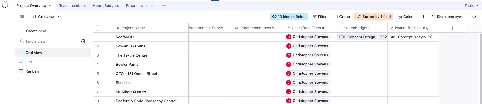

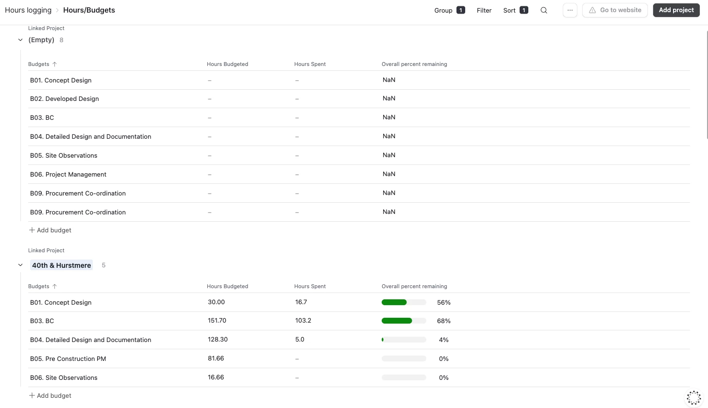

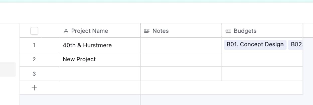

Hmm the new budgets you created should automatically be linked back to the new project. Would you mind sharing pictures of
1) The new project record you created and what’s in the linked Budgets field
2) The new Budgets created and what’s in their linked project field
3) The record template you created
That should help me figure out what’s going on. Thank you!
Hi BuildForAT,
Thanks so much in advance for your help. Hopefully this is what you mean?
Ah, It’s come in under a hidden field in my hours table. Should I relink the projects all under the ‘Project overview’ column to keep things clean, or can i get the project to link to ‘linked project’?
BuildForAT
  • July 11, 2025
​@Lauren_Marshall_CTRL Yes, you can do either. 👍
The first option would be much easier to do as you can just copy and paste those linked values over. If you want to do the second option, let me know!

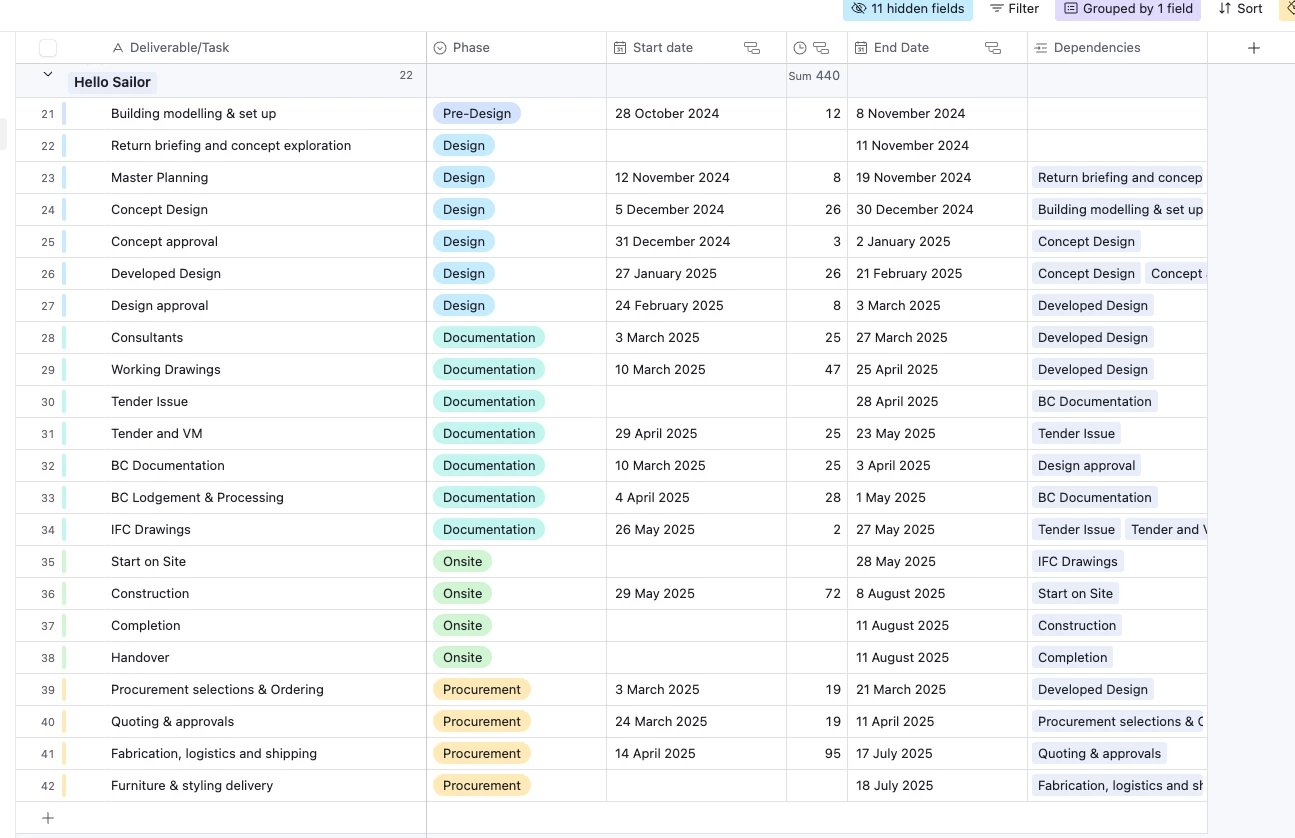

I have a similar requirement for the programs component of our work flow. I have built this in based on a live project but would be great to have a template ready.
I have a bunch of dependencies all set up. Can I apply a template with so much detail?
Please see example below
BuildForAT
  • July 14, 2025
​@Lauren_Marshall_CTRL it’s my pleasure to help!
I always encourage exploration. So I would say: Give it a try to see if you can create a record template with all that detail! Because either way you learn something. If you can, then you can. If you can’t, then you’ve discovered a limitation in Airtable.
(Hint: the answer is you can. You likely will be able to set the name, phase, duration, and dependencies. The start date might be tricky)
