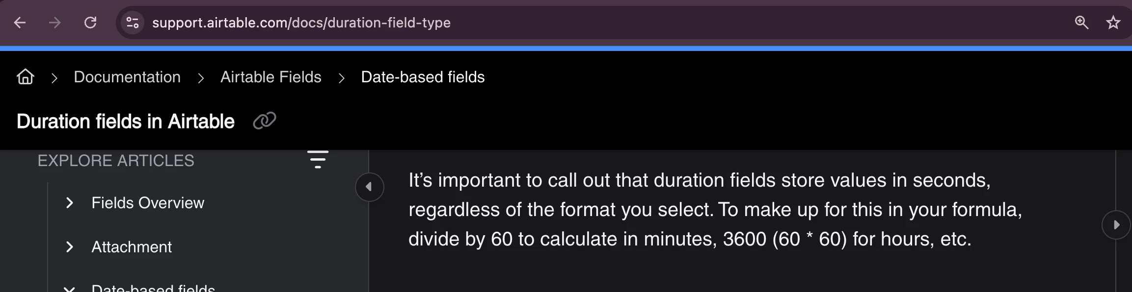

Hey ​@Mai_Nguyen,
For further cont​@DisraeliGears01 answer above, you can check this Airtable support article for Duration fields. -screenshot of relevant part below.
Depending on how and on what software your automation is setup whether you’ll want to process the data on the automation itself, or whether you will want to handle it on google sheets.
