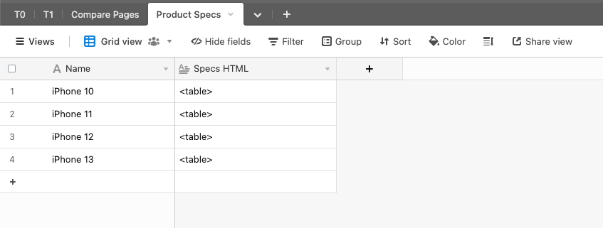

I am trying to make a two product comparison page. I have all product specifications in one table like this:

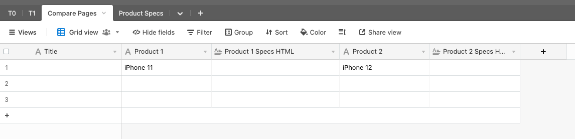

And I want to pull the specs data on this other "compare pages" table depending on which two products are picked:
So if Product 1 is "iPhone 11" then it would pull the specs into this "Product 1 Specs HTML"from the first table. Same for product 2.

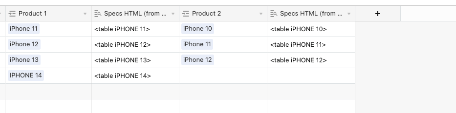

Best answer by n0xp
You're close enough.
In your comparison table, change the field type for Product 1 and 2 to the 'Link to record' type and select 'your table Product specs.
Then in your Product 1 specs and Products 2 specs fields change the type to Lookup fields. And make them look up your Product and then the Product specs.
(this might look confusing on text, but go through it step by step in Airtable, and it'll make sense)

This worked! Appreciate the help 🙂 Here's a screenshot:
