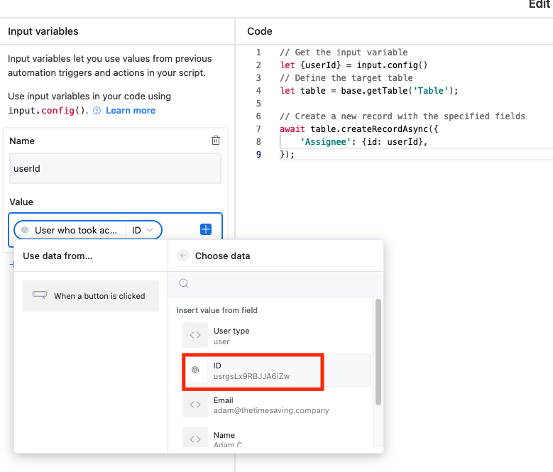

Try changing your input variable to be the user ID instead:
And then use this:
// Get the input variable let {userId} = input.config() // Define the target table let table = base.getTable('Table'); // Create a new record with the specified fields await table.createRecordAsync({ 'Assignee': {id: userId}, });

  • Nov 6, 2024 2:38 AM UTC
And then use this:
If your User field allows for multiple users, you'll need to use the following for the record creation bit:
// Create a new record with the specified fields await table.createRecordAsync({ 'Assignee': [{id: userId}], });
That worked great!
I think one problem was just that I did not understand using ID as input and even as the value in the field would work to actually put the name when looking at the table, so I just avoided it. Thank you for making me try it!
