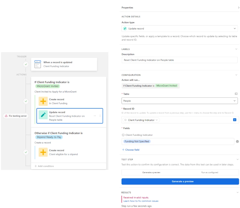

I am learning automations and I have hit an error I cannot figure out.
There are two tables involved in this automation:
  1. People table where the client master data resides
  2. Client Funding table where clients' stipends and grants get recorded
Here is the logic I am trying to make happen:
  1. When Client Funding Indicator field changes to "MicroGrant Invited", do two things
    1. Create a new Client Funding record for the client <-- This step works correctly
    2. Reset the Client Funding Indicator field to "Funding Not Specified" <-- This step gives me the error "Received invalid inputs."
Thank you!!!
Ah, you need to use an "Airtable Record ID" in the "Record ID" field in your "Update Record" step:

Thank you so much. I thought I tried that but clearly I did not as it worked perfectly. Appreciate it.
