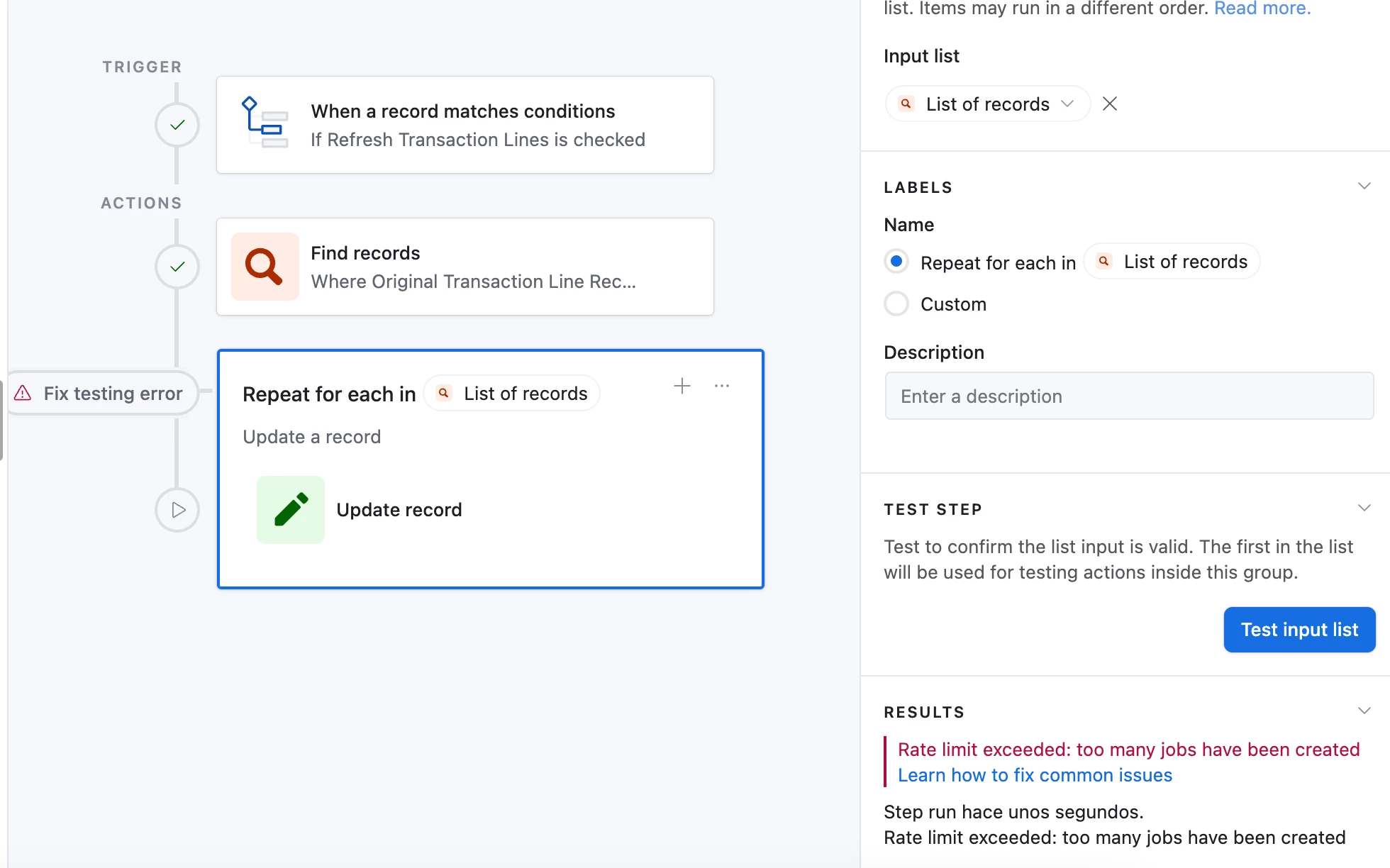

All automations which include a Repeating group on a given base are erroring.
When testing, error shows: “Rate limit exceeded: too many jobs have been created.” -see image below.
When running on its own, error shows: “Invalid Input List”
No automation runs limit has been met, No API call limits have been actually exceeded, Find Records limit has not been exceeded, Repeating Group limit of items/records which can be looped has not been exceeded. Automations worked great for months/year, but started erroring all of a sudden yesterday. Nothing has changed. I tried building new automations with repeating group, and even new automations fail. (started implementing scripts instead of repeating groups, and scripts do work)
I already reached out to support, but did not receive a human-like answer yet.
​@ScottWorld ​@TheTimeSavingCo ​@kuovonne any thoughts, ideas, similar experiences? Wanted to share this with you.
Thanks guys!

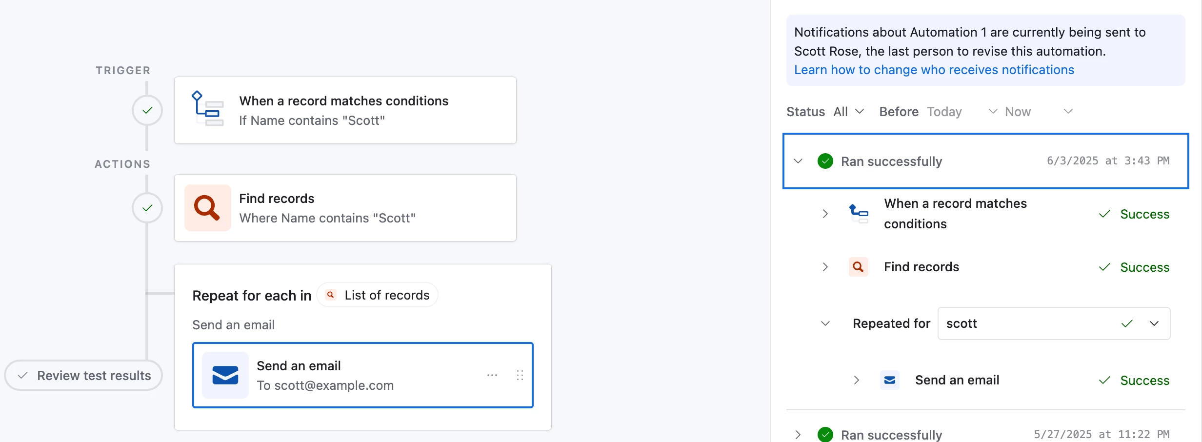

Hi ​@Mike_AutomaticN,
I’ve never seen that before… and I just tested this on my end, and it worked fine for me. (See my screenshot below.)
So it’s probably some sort of a bug on Airtable’s end… it’s good that you opened a support ticket with them!
