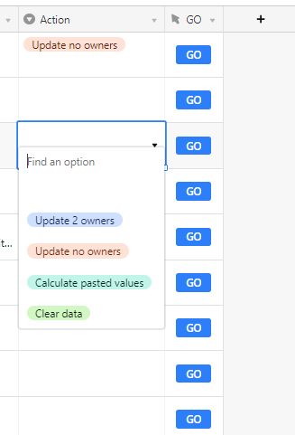

I can’t suggest workaround for your request, just want to share my use-case for several actions on a table. Maybe it doesn’t fit your needs, but can push some new ideas?
Single-select to choose option, GO button to run action. Script reads option value.

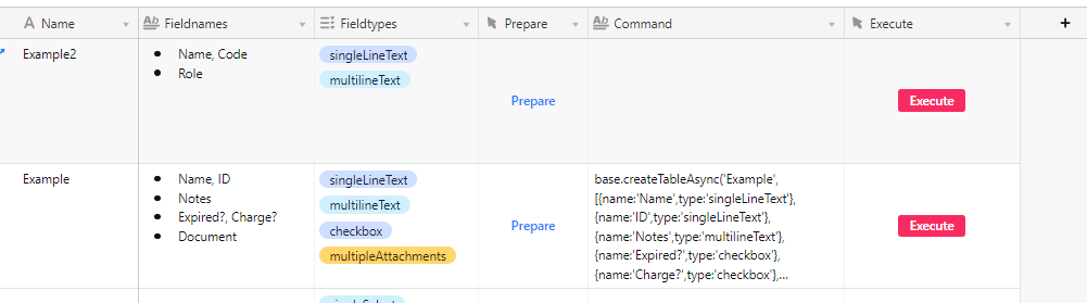

If different actions are parts of some workflow, with some output and should be launched one by one, it can be detected by the output existence. ‘tablecreator’:
  • June 22, 2022
@Alexey_Gusev -
I appreciate you sharing your approach. I think the stacking of commands via multi-select dropdowns is a clever approach to rapidly setting up custom blocks of actions with a single trigger. It’s not a good fit for my situation, but I think it’s a neat idea for the right circumstance.
