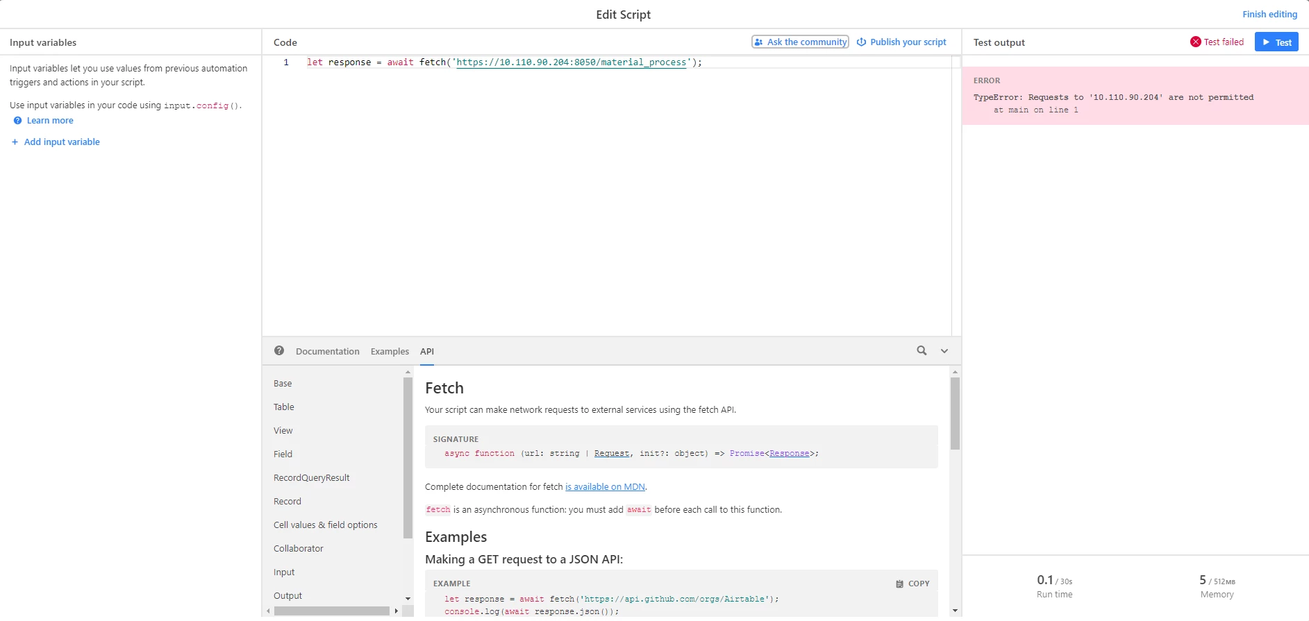

Hello !
I am encountering a problem when creating an automation script for one of my tables.
I set up a trigger to occur when the user creates a record. I then wrote a script to be run as an action of the trigger. This script contains a 'fetch' call to a local Flask server where we will do all the process ensuing this trigger activation.
Unfortunately, whenever I test my script, it always indicates :
TypeError: Requests to '10.110.90.204' are not permitted at main on line 1
Here is the script I am using :
let response = await fetch('https://10.110.90.204:8050/process');
Can you help me with this, please ?

Hello ag314, thank you for your reply.
Unfortunately, I still have the same problem. I tried doing the same via the Scripting Extension. When using "fetch()", I have the following error :
ERROR TypeError: Failed to fetch at main on line 10 This error might be related to Cross-Origin Resource Sharing (CORS), a security mechanism that prevents websites from making malicious requests to other sites. Unfortunately, it also stops some legitimate use-cases (such as calling an external API from the scripting app). You should be able to find some more information about this error from your browser's network developer tools, usually accessed by right-clicking on the page, choosing inspect element, and selecting the console tab in the panel that opens. If you see notices or errors that refer to CORS or Access-Control-Allow-Origin, it's likely you've encountered a CORS error. The scripting app can't reliably detect CORS errors in all browsers, so you should double-check your code to make sure there aren't other errors (e.g. a mistyped domain name) that could be causing this instead. You can try using the remoteFetchAsync API or a Scripting Action which both don't run in the browser and therefore don't have CORS limitations. You could also try contacting the API provider to ask about enabling CORS, or post on the community forum to see if there's a workaround for your specific API.
When using remoteFetchAsync(), I have this :
ERROR j: Error: Requests to '10.110.89.105' are not permitted at main on line 10
 The Flask server I use for testing has the following code :
app = Flask(__name__) cors = CORS(app) @app.route("/process", methods=['GET', 'POST']) # used for airtable webhooks -> programming notifications def process(): print(request) json_string = "webhook received" resp = Response(json_string) resp.headers['Access-Control-Allow-Origin'] = 'https://airtable.com' return resp if __name__ == '__main__': app.run(host='10.110.89.105', port=8050, ssl_context='adhoc', debug=True)
 I do not know what to do from here... I think I am missing something but the question is ... what ?

Sure ! Here is the fetch code :
let url = 'https://10.110.89.105:8050/process'; const options = { method : "GET", headers: { "Content-Type": "application/json", "Access-Control-Allow-Origin" : "https://airtable.com" }, }; let res = await fetch(url, options); let response = await res.json(); console.log(response);

I added the console.log(res) thing but it says the same thing : "Requests are not permitted".
I think the execution cannot reach the console.log() because of the fetching blocking it with the await.
So I tested without "await" to see what happens, with the following code :
let url = 'https://192.168.1.12:8050/process'; const options = { method : "GET", headers: { "Content-Type": "application/json", "Access-Control-Allow-Origin" : "https://airtable.com" }, }; let res = fetch(url, options); console.log(res);
 And it returned this :
CONSOLE.LOG {}
And also the same message as before :
ERROR TypeError: Requests to '192.168.1.12' are not permitted at main on line 10
