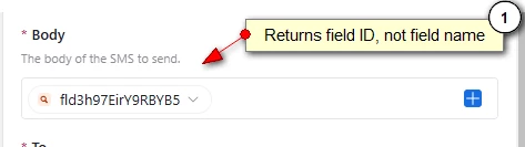

I have a situation just arise in the last hour. In Script, when I use the select control to get a field from a Find action, instead of returning the Field Name, it returns the Field ID. The selection process seems normal, and I see the field name and the value in the picker, but it returns the field ID instead, which does not work. It’s happening in several places. I’ve tried shutting down and opening again and creating a new automation, but I can no long select fields. Any thoughts?

This is happening in more than one base. When I Find a Record in an automation, when I try to select a field in script config or an email field, the Field ID returns instead of the name of the field. I’m not able to do any development until I can figure this out. Please help. thanks.

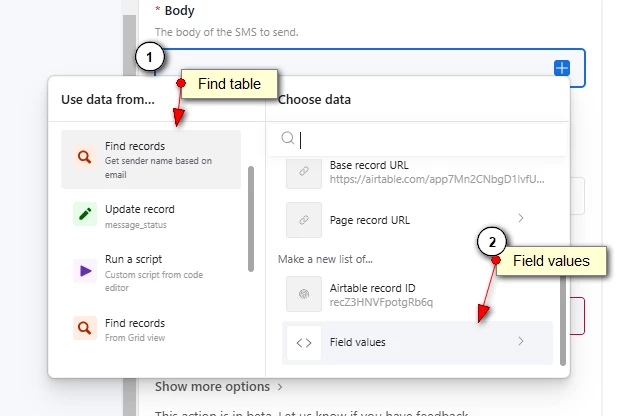

As a data point when I try to use the results from a ‘Find Record’ action and a single select field it looks like this for me:

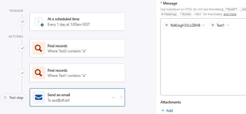

I saw that Airtable behaviour in similar case, when trying to use array of values where the system expects a single string value. And I saw it before, maybe less than month ago, but more that week, but I didn’t care because it worked as I need - converted this array into a comma-separated list. The issue is only about a name of token in Automations UI, Field Name vs Field ID

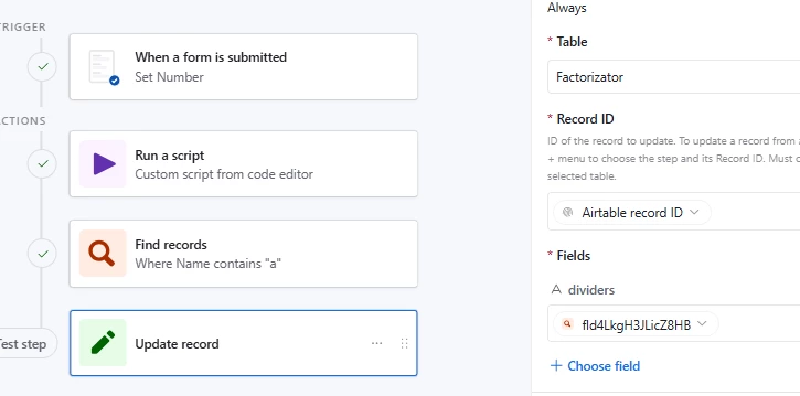

I managed to get both results for similar Find records actions, It happens even in Update step
after some investigation I found that it happens when trigger table is different from Find Records table. But it doesn’t happen when a trigger has no table at all, like scheduled time.
So it can read Fieldnames only in table with Test1
Even when I changed the order of Find Records, it still uses same table

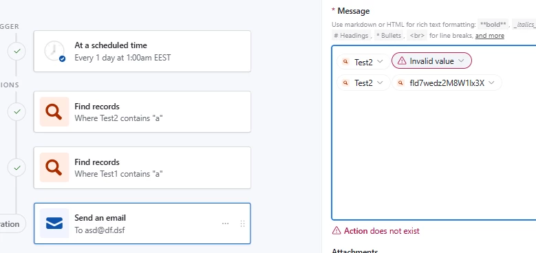

But when I removed step with Test1 and created again, it is now using Test2 for field names
Old token became invalid, new token now shows field ID. Test2 is OK.
So it seens like automation uses some exact table to translate Field ids to names and that table defined somehow. (by trigger, or if trigger is table-independent, by other actions during automation)

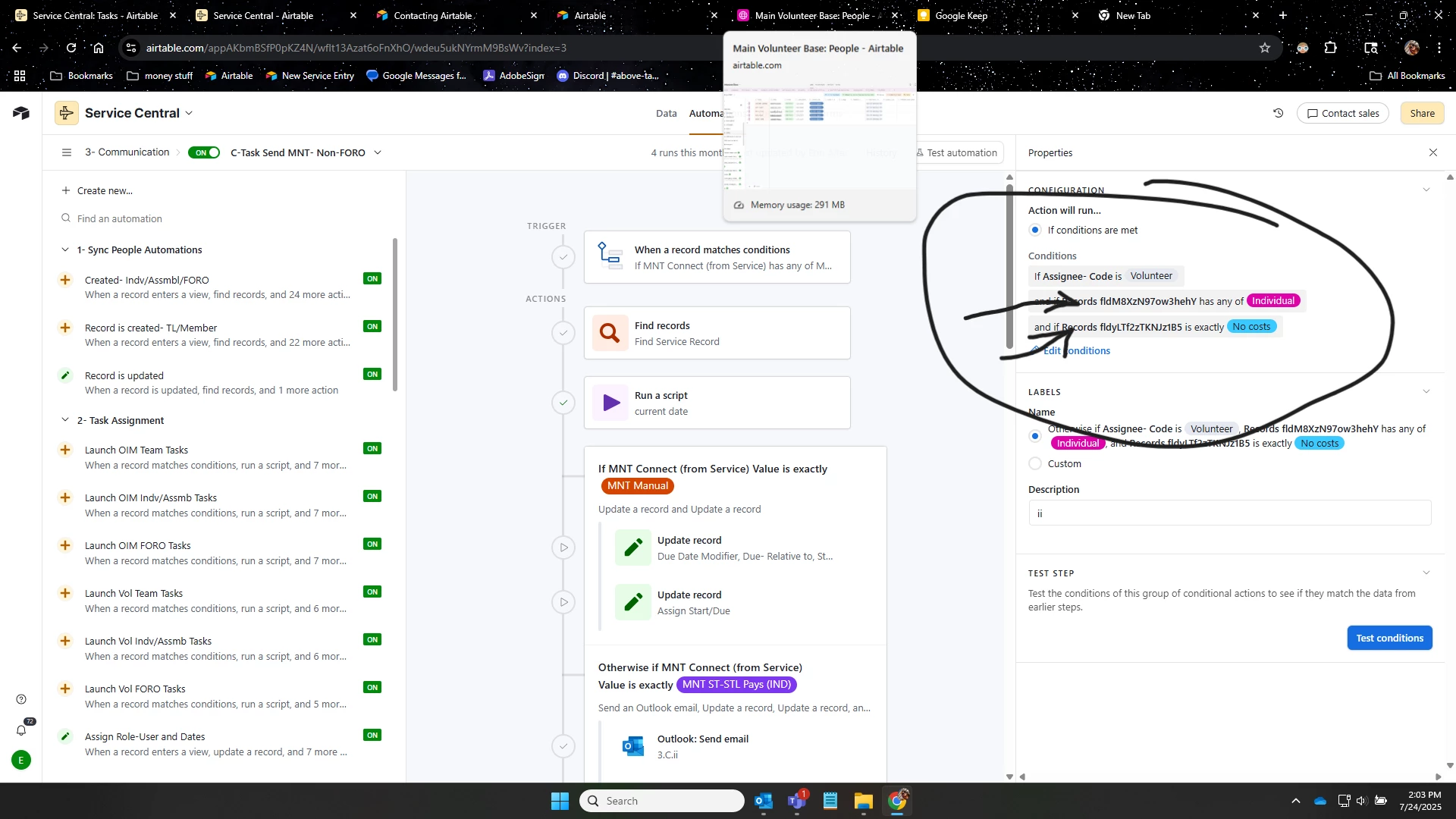

i think i am experiencing the same or a related issue. i was trying to work on a conditional automation and when i try to click on the “edit conditions” to see what is happening with this long string of code, it errors out.

Forum|alt.badge.img+14
  • July 25, 2025
the issue i was experienceing seems to have resolved overnight. i did not get any help from support, but the fields are now legible and i am able to edit my automations again. so that is good.
