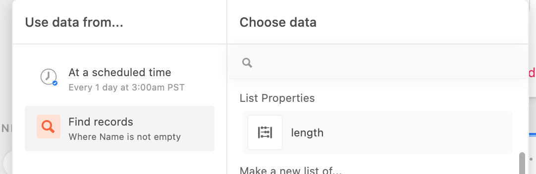

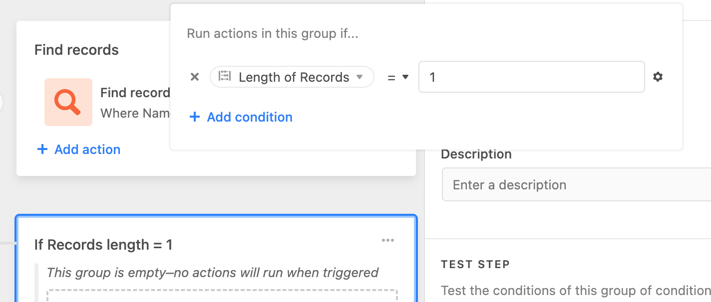

Assuming that the find records step is in the top Actions section and isn't already a Conditional Action, this should be a pretty easy fix if you make all actions following the Find records step conditional.
You'll need to add a group of Conditional Actions and you can set the condition to be only when the number of records found is exactly 1. Then, you'll just need to drag and drop the actions that should happen only when a record is found into that grouping. Since the actions will now happen only if a record is found, you'll no longer see errors when there is no record that matches the find step.

Thanks for this!  Didn't think about conditional actions based on the number of found records.  So this helps me in cases where the records > 0
One issue, though: What is the "find records" action find 0 records?  It seems like it's failing at that step because finding 0 records triggers a fail.  Any thoughts about that?
