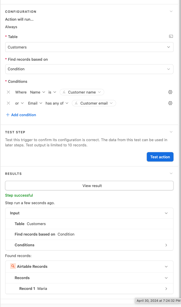

My "Find records" step has two conditions (OR), attempting to match on "Name" or "Email".
Here you can see a successful test, when a match is found:

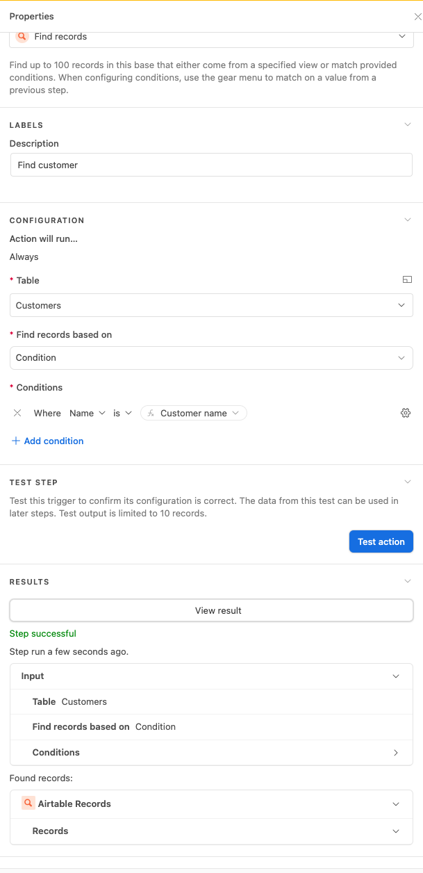

It is also successful when no match is found, BUT when only "name" is used, and not both name and email, finding 0 results (expected behaviour).

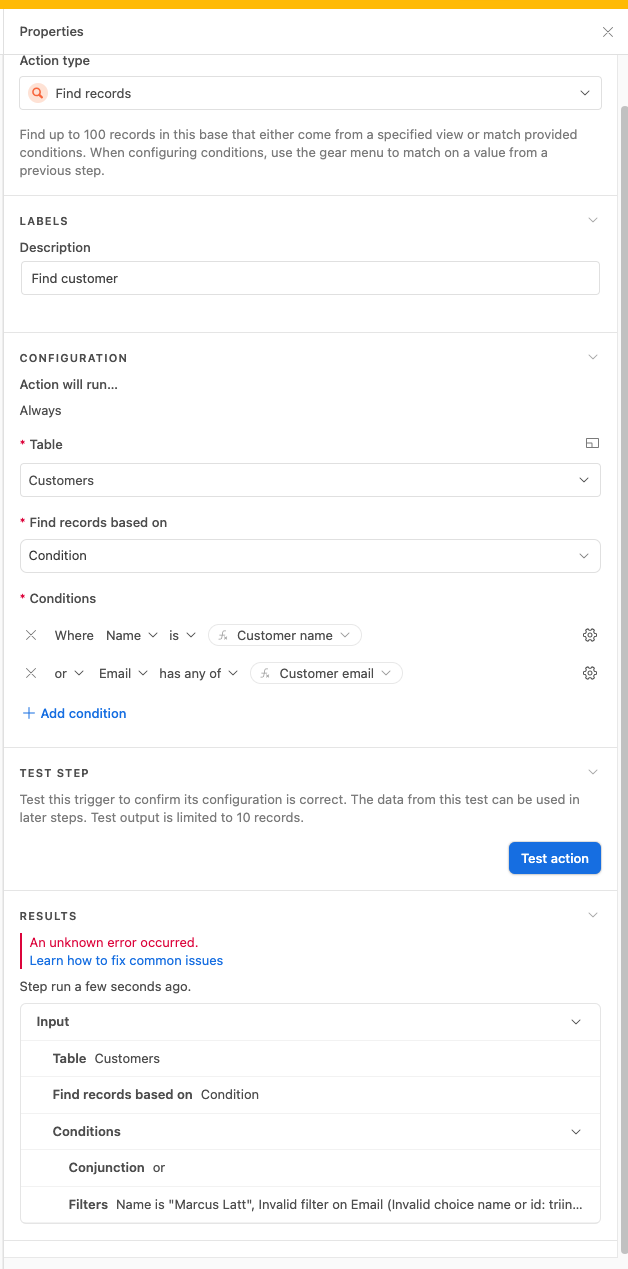

BUT when adding the email condition bac, when there are no matches, it gives the error:
This seems like a bug to me, can you advise? Thanks!!

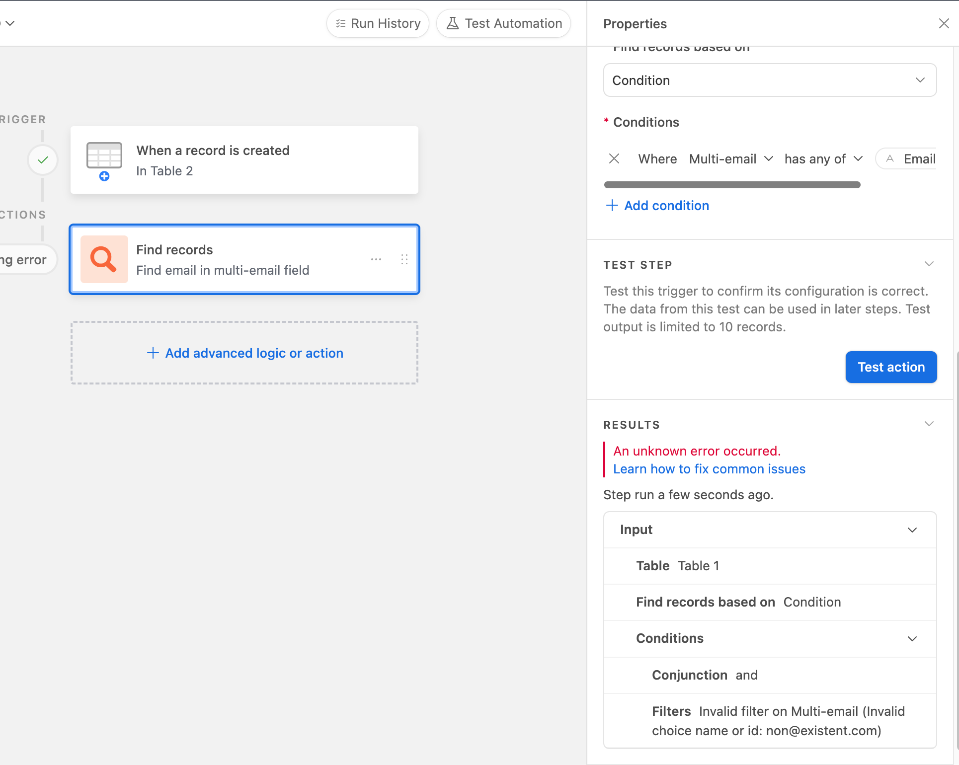

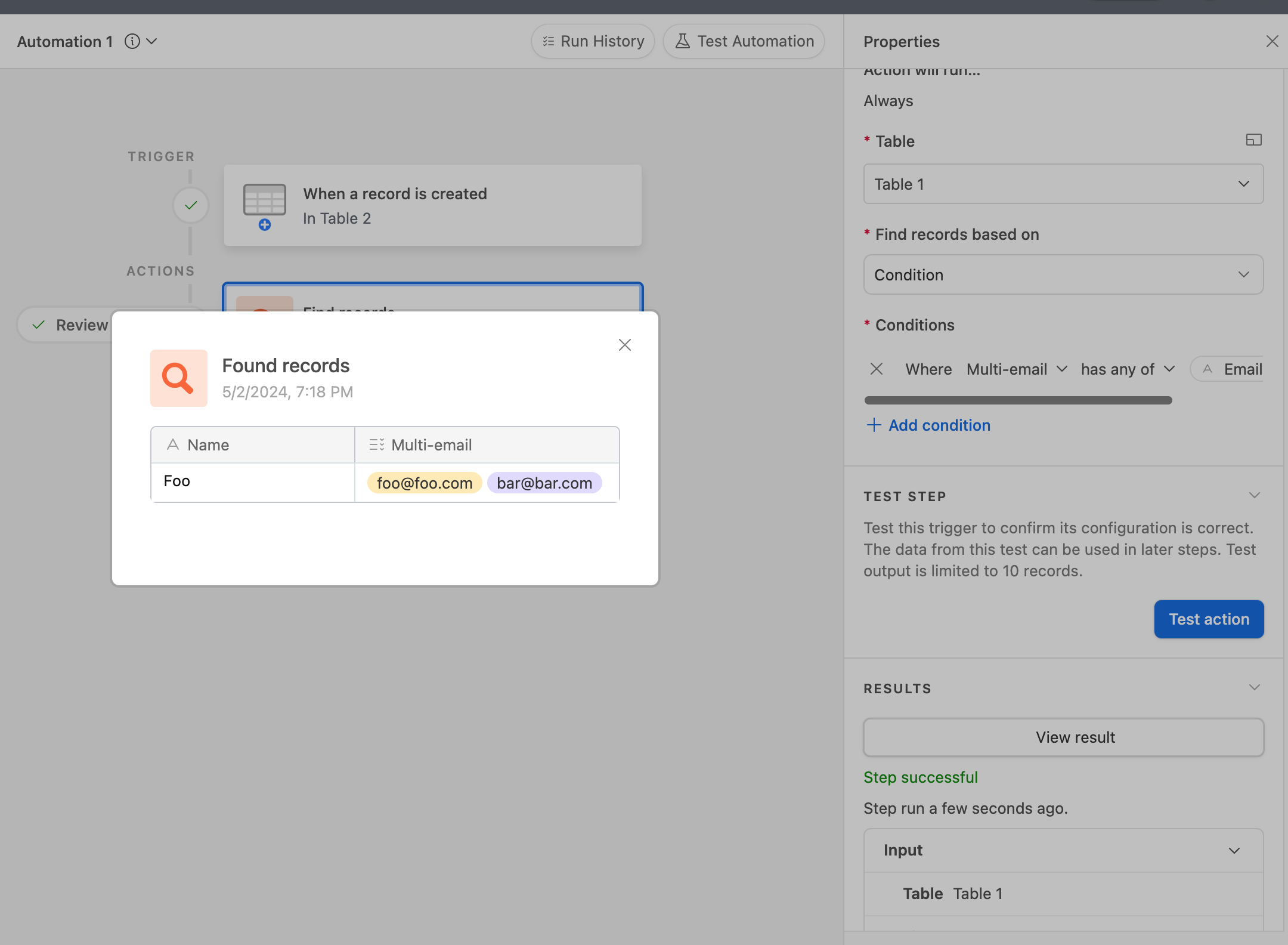

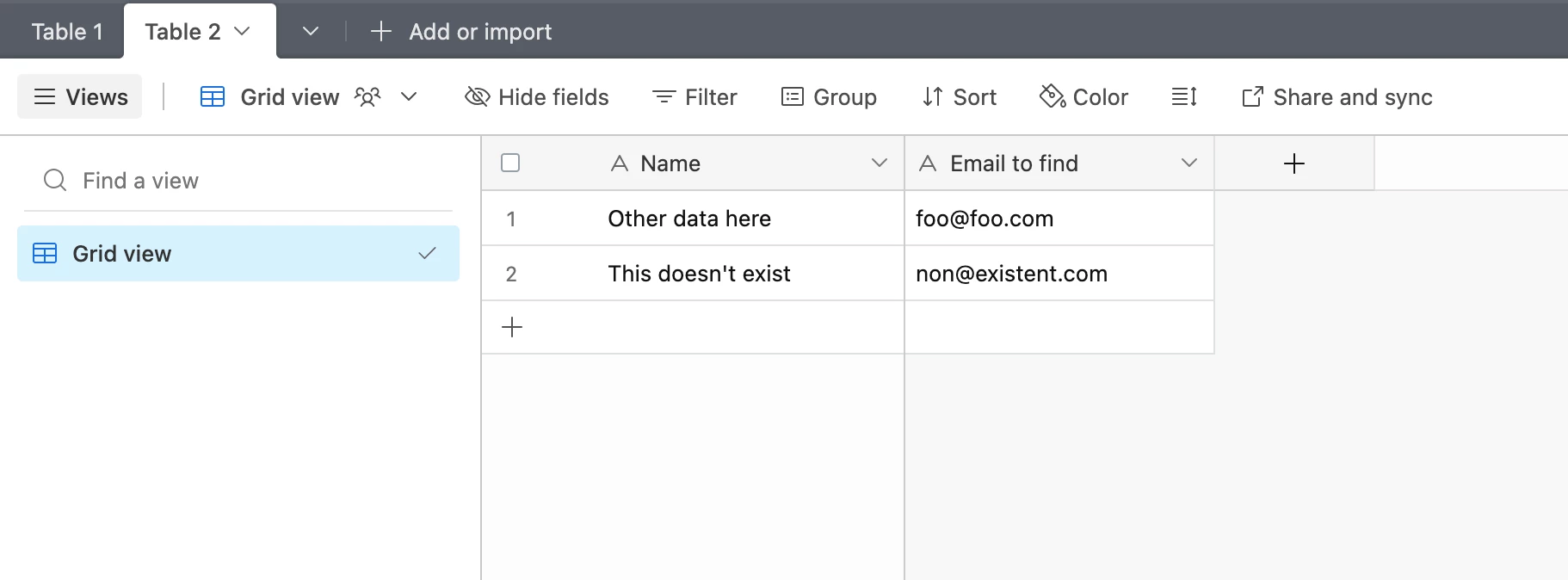

I created a new base, with two tables and a very simple automation to look up the email only. It's worth mentioning that the email field in the "Find records" table is a multi-value field.
Trigger: new record in Table 2
Find records: from Table 1, multi-email field (multiple select field)
When a matching record exists (correct behaviour):
When no matches exist (error - expected "no records"):
Table 1 (to look up records from):
Table 2
Will send you a DM with a link to the base. Thank you!!

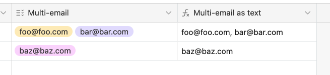

I got the invite, thanks!  I think this is happening because when we try to do a "has any of" condition in a multiselect it expects us to pass it a select option instead of text
As a workaround, I created a formula field to output the multiselect options as text and used that in the condition and it seemed to do what you need!
Table 2

Thanks a lot, that works!!
