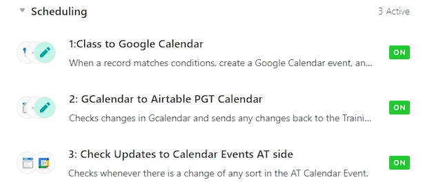

Hey all!
So I wanted to create an event, and CLEAR or DELETE the Google Calendar even when a checkbox/flag is clicked. This would be used when we cancel or reschedule but don’t want to delete the original entry.
Currently I have three automations:
These all work beautifully, but I wanted one more automation, unless the #2 could also update, but figured it’d be better to keep it separated as its own unique automation.
Any ideas? I don’t see an option “Delete Google Calendar Event”.
Thanks.
Sean L

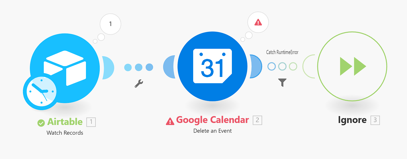

Sean_Lake1
Forum|alt.badge.img+20
  • Sep 16, 2022 1:01 AM UTC
Cool, now you have the basics of Make.com there are endless possibilities. You will need to set your scenario to ON for it to continually watch Airtable, be aware of how many operations you get in your Make plan and adjust the update frequency accordingly.
I did however, get an email that the scenario was shut off due to errors? Do I need to UNCHECK those that are deleted now or?
Forum|alt.badge.img+16
  • Sep 16, 2022 8:44 PM UTC
I don’t know, you need to review the error messages that make sent you.
Sean_Lake1
  • Sep 16, 2022 9:48 PM UTC

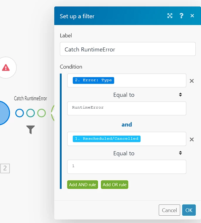

Sean_Lake1
  • Sep 16, 2022 9:50 PM UTC
I’m guessing, ignore the RuntimeError would be fine, because obviously, after it’s been deleted, it’s not going to exist everytime the scenario processes, right?
Is there a checksum that can be add in there somewhere that checks for it already have been deleted?
Sean_Lake1
