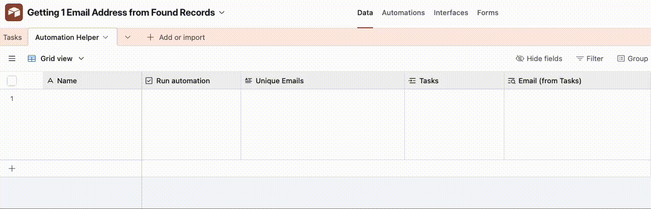

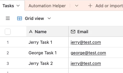

Here’s an example base I set up
Assuming your data looks like this:
And your goal is to have a list of emails that looks like this:

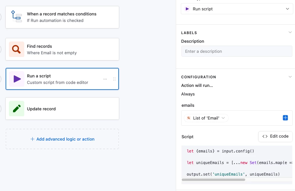

And this is how the automation setup looks and works in practice:

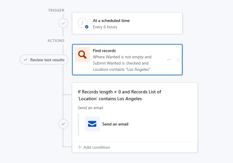

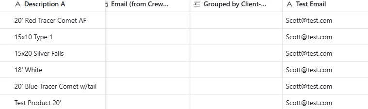

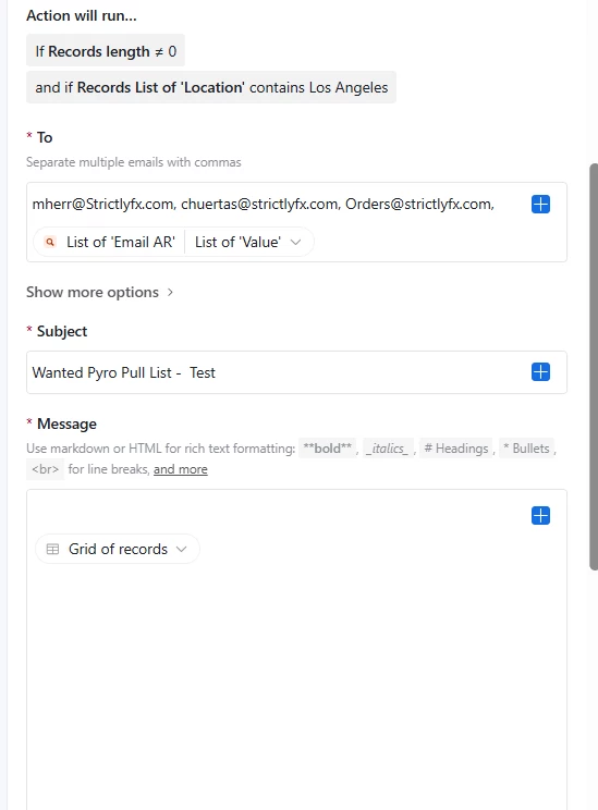

I have an automation that Sends this list to pre set emails I also want to send it to the Test email. Right now it will put the test email in the CC line 6 times. It does only send 1 Email to the Test email. Is there a way to clean it up. the script above gave me a snytax error when I tried it.
Hm, that’s weird.  Could you provide screenshots of the automation setup?  If you could private message me a read-only link to your base so that I can troubleshoot it directly that’d be easier too
  • Nov 11, 2025 4:16 PM UTC
  • Nov 11, 2025 8:14 PM UTC

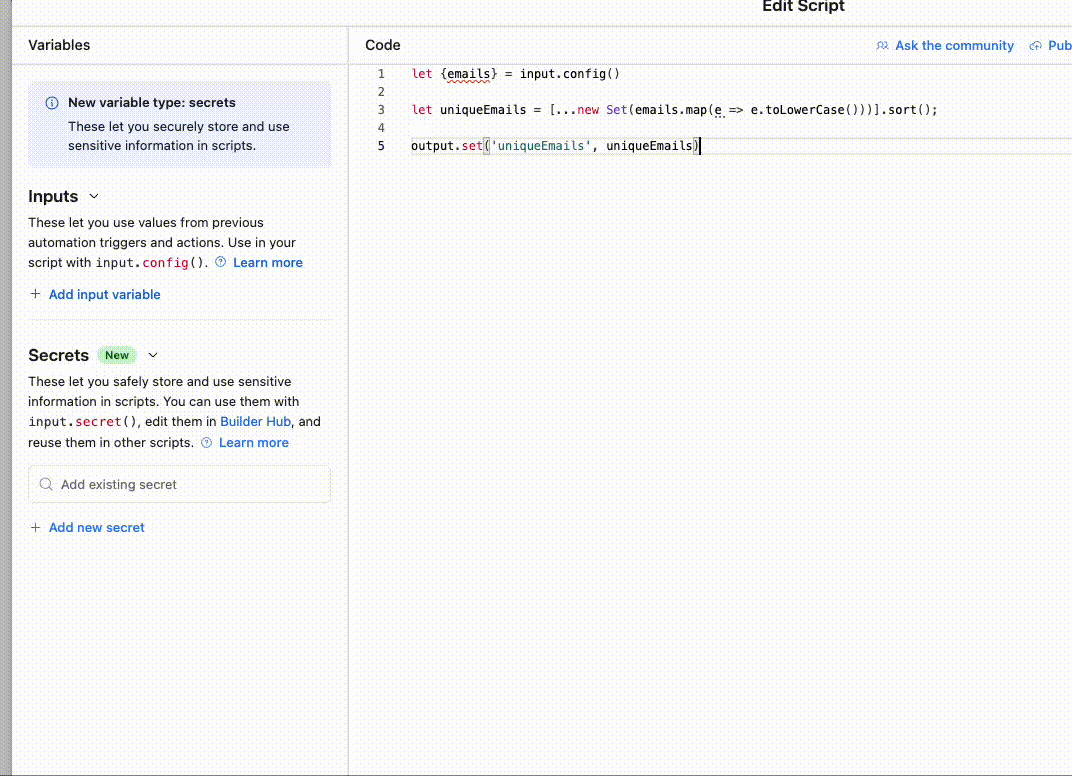

Thanks for the link to the base!  The reason you’re getting a syntax error for the script is because we need to set the input variable on the left, and here’s how you’d do that:
Could you try setting this up and testing the script out again?  It should give you a unique list compiled from the Test Email values
  • Nov 12, 2025 5:25 PM UTC
that worked. Thank you.
