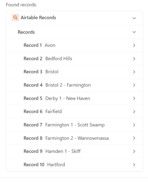

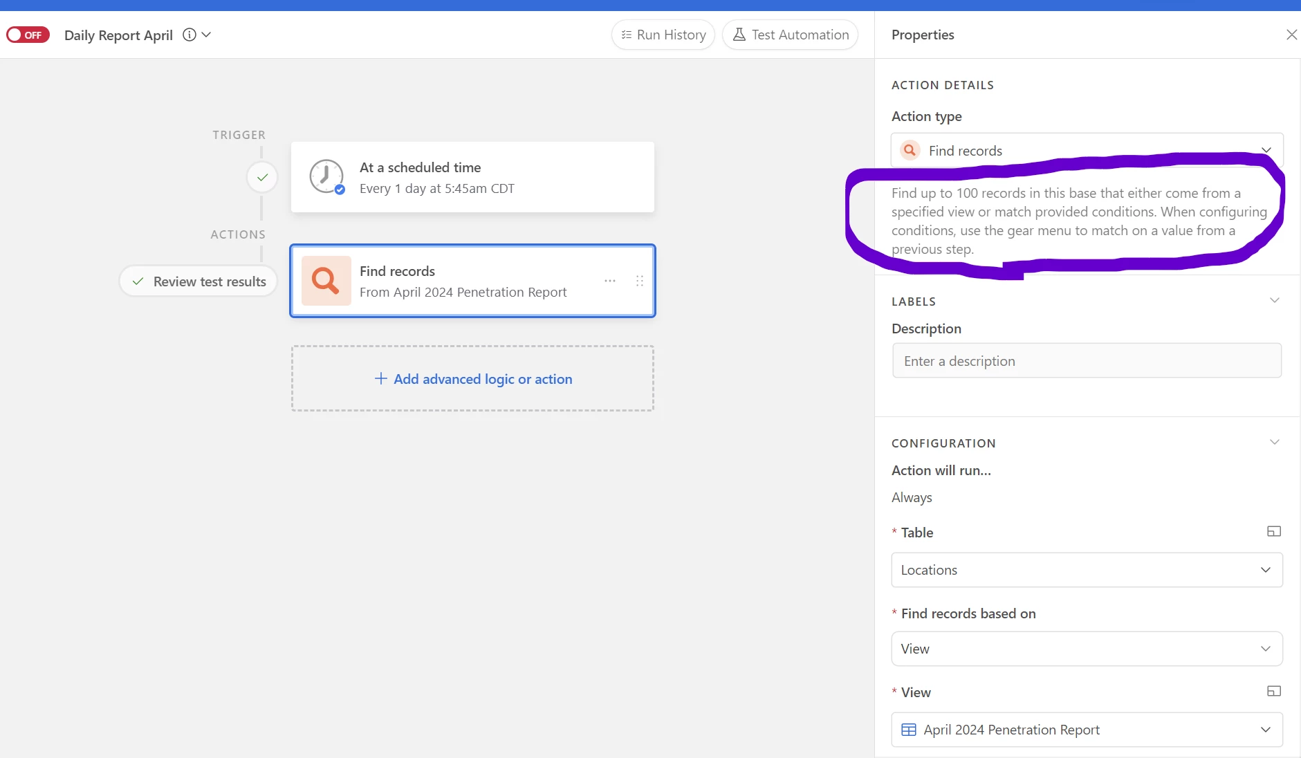

See screenshots below - I've used the "find records" option many times, and always restrict it to a specific view.  Only this time, and any time I test the find records action anywhere globally, it suddenly seems to stop at 10 records.
The description still lists the limit as 100 records, it just stops at 10.  The view in question has 52 records in it. I've even went so far as to test this on older automations which we've since stopped using (afraid to touch any currently running automations for fear they might stop working properly).
I've recreated the automation, refreshed the page, re-sorted/grouped records, but have not been able to work around the issue.

2025 Update:
This seemed to be a bug back in 2024 which is now fixed.
However, if you're still having this problem, It's possible that you're simply trying to test or preview your automation from the Automations screen itself.
During a test of an automation or a preview of an automation, Airtable will only find a maximum of 10 records during all the tests & previews.
However, once you actually trigger the automation and it runs all on its own, it will find all of your records for you.

I got an update from Airtable support.  They've limited testing (temporarily) to 10 records while their developers are working on enhancing the find records automation to go beyond the 100 record limit.
I have been advised that any test of the automation will always return 10 records, as will any subsequent test of automations relying on the find records automation.  This includes not just testing individual steps, but hitting the "test automation" button (I frequently use this to send/resend reports as needed).
That being said, actual automation runs seem to be working properly as of now.
