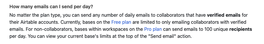

Do note the following limitation outlined here
If we can’t send emails, then I’d set up the action to be to message me on Slack or make a calendar event for me to notify the client or something
