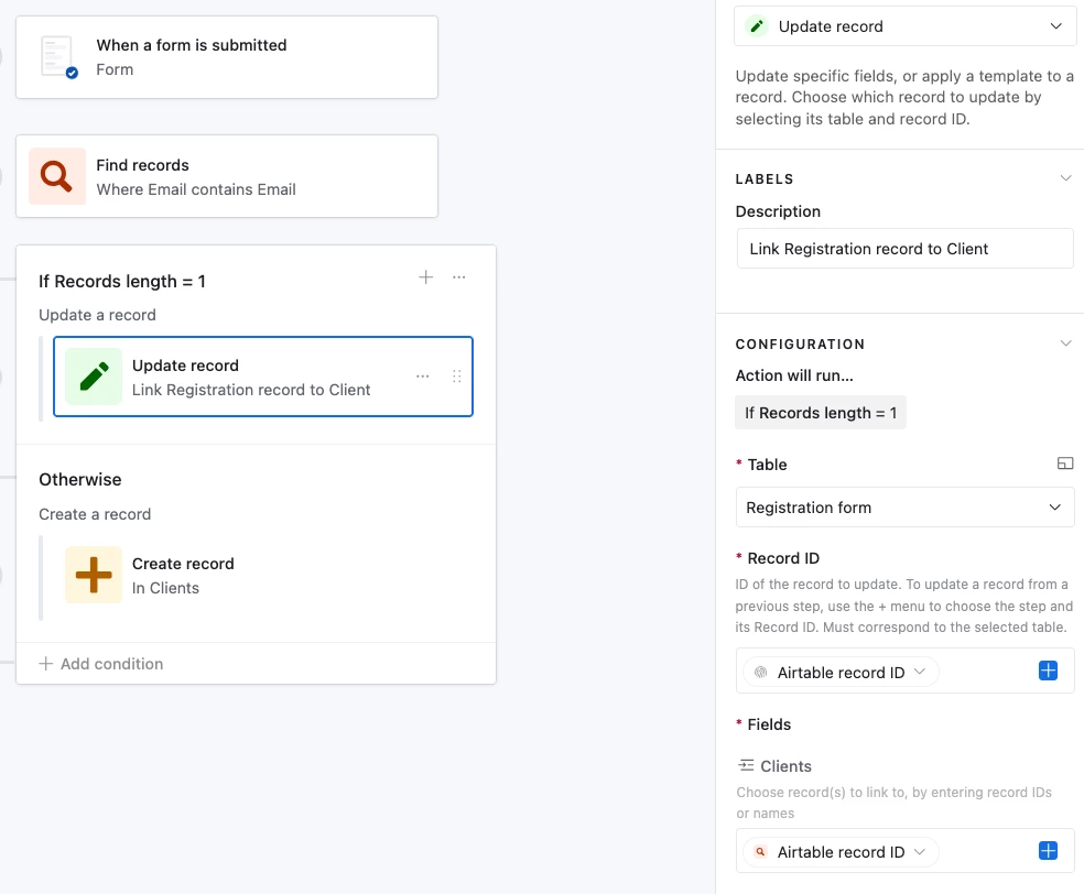

I have two tables : “clients” and “registration form”. I want to be able to send a registration form to any client no mater if the client is already in my “clients” table or not. (I also have a course table).
Lets say I ask for the clients email in the form. If the clients email is already present in my “Clients” table, I want to link the newly created “registration form” record to that specific client in the “Clients” table. If not, I want to create a new record in the “Clients” table with the new client info.
Is it possible to achieve this with Airtable or with other tools like fillout? Thank you very much!

Yes, this is possible with either Fillout’s advanced forms or Airtable’s native forms.
In either case, you can just create an Airtable automation that does this for you.
You would use the “Find Records” action to search for the user’s email address in your Clients table.
Then, you would add a conditional action after that.
If the length of your Find Records action = 0, then the Client doesn’t exist, so you can create a new client.
If the length of your Find Records action > 0, then the client does exist so you can link the form to their existing record.
Note that this will fail if the Find Records action finds more than one client with the same email address. In that case, you would want to turn to more advanced automation tools like Make’s advanced automations for Airtable.
Hope this helps!
If you have a budget and you’d like to hire the best Airtable consultant to help you with this or anything else that is Airtable-related, please feel free to contact me through my website: Airtable consultant — ScottWorld
Yeap you can do this with Airtable and I’ve set up an example base here for you to check out!
Here’s how the automation would look:
You can duplicate the base and check out the set up, and if you get confused you can refer to Airtable’s guide on how to link existing records here:
https://support.airtable.com/docs/linking-existing-records-using-automations

Ok, thank you again for all the info. I will push my newbie luck once more with one more question, I appreciate the help.
So right now, with automations, when a registration form is filled I managed to achieve the following :
-If the client’s email is not in the “Clients” table, a new record is created for that client that include a link to the registration form.
-If the client’s email is already in the “Clients” table, it’s record is updated to include a link to the registration form.
A problem arises when a client fills two registration forms. Then, in the client’s record, the link to the second registration form overwrite the link to the first form that is already there. I found a couple discussions that points to potential solutions using commas but I couldn’t make it work.
How would you adresse this? Thank you so much!
  • October 21, 2025
There are 2 different ways to do that, but this is the easier of the 2 ways:
Instead of updating your client record in the client table, simply update the registration record in the registration table to link to the Client ID that you just found in the “Find Records” step.
There is ALREADY a linked record field in your registration table that “back links” to the clients table. Airtable automatically created that linked record field for you in your registration table. If you don’t see it, check the “hidden fields” button in your toolbar.
So all you need to do is update that linked record field in the Registration Table with the Client ID.
Hope this helps!
  • October 21, 2025
That works, thanks!!
