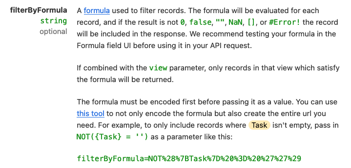

I think you need to encode the formula before use.  Here's your formula encoded using Airtable's API Encoder tool:
AND(NOT(%7BCurrency%7D+%3D+'')%2C+%7BExchange%7D+!%3D+''%2C+NOT(%7BStage%7D+%3D+'Stage+4'))
Relevant bit of the docs:
