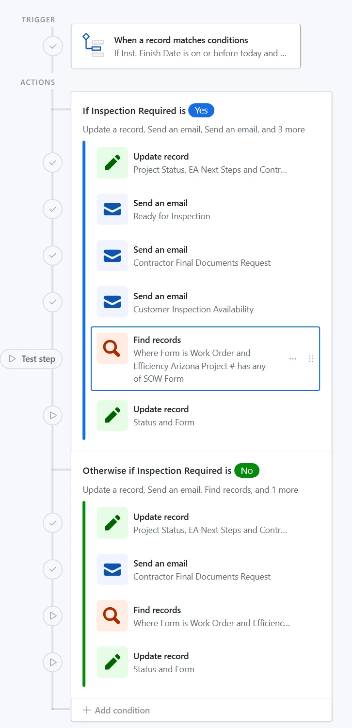

Here is my current automation:
Everything works for both conditions until it get to the Find records action. The records are linked in both tables.

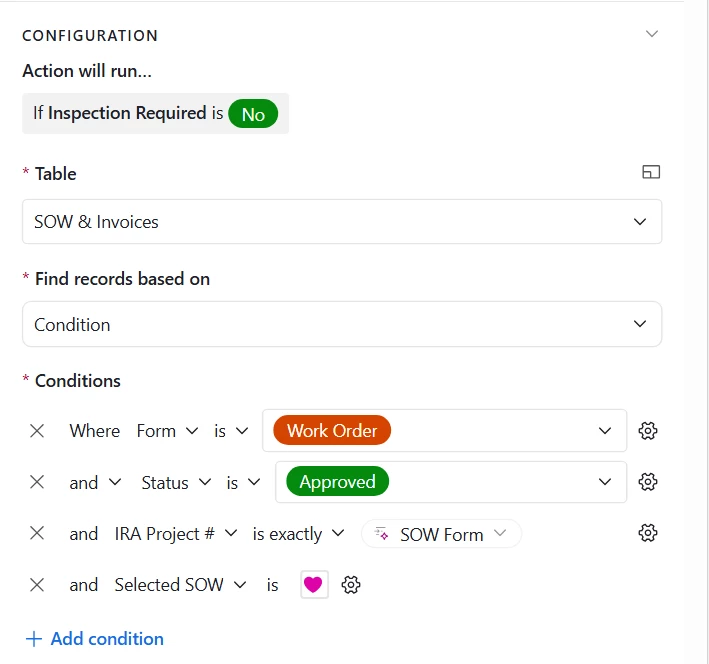

Here is my configuration (same for both conditions)
I’ve tried pulling the SOW Form from both the trigger step and the first update record action, but neither seems to find any records. I’ve tried changing the condition for the project #’s to “has any of”, “is exactly”, “contains” (which doesn’t allow me to select the SOW Form field), but no difference as far as I can tell.

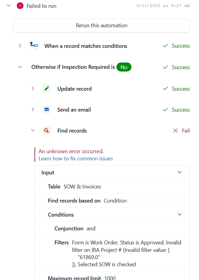

Here’s the error I’m getting. From this I can tell it’s not finding the project #, but I can’t figure out why. I have the Name selected for what it’s looking for in the SOW Form field and I know these 2 fields match.
