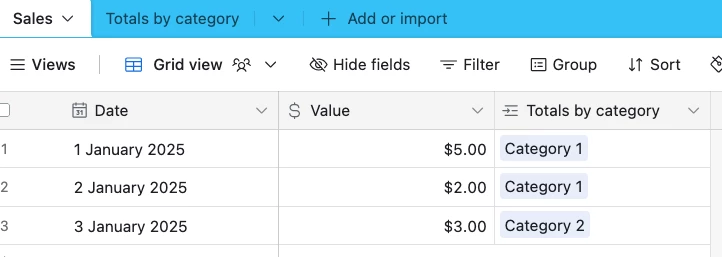

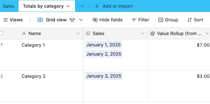

Does this look right?
Link to base
If so, you'll just need to create a link between your 'Sales' table and your 'Totals by Category' table, and then create a rollup field in 'Totals by Category' to sum the totals
To populate all your existing data, click on the field header for the existing 'Categories' field in 'Sales' so that the entire column is selected then hit CMD/CTRL + C.  Then, hit the field header for the linked field to the 'Totals by Category' table, then paste in the data.  This'll link everything up for you and if you go to 'Totals by Category' you should see all the data you want!
