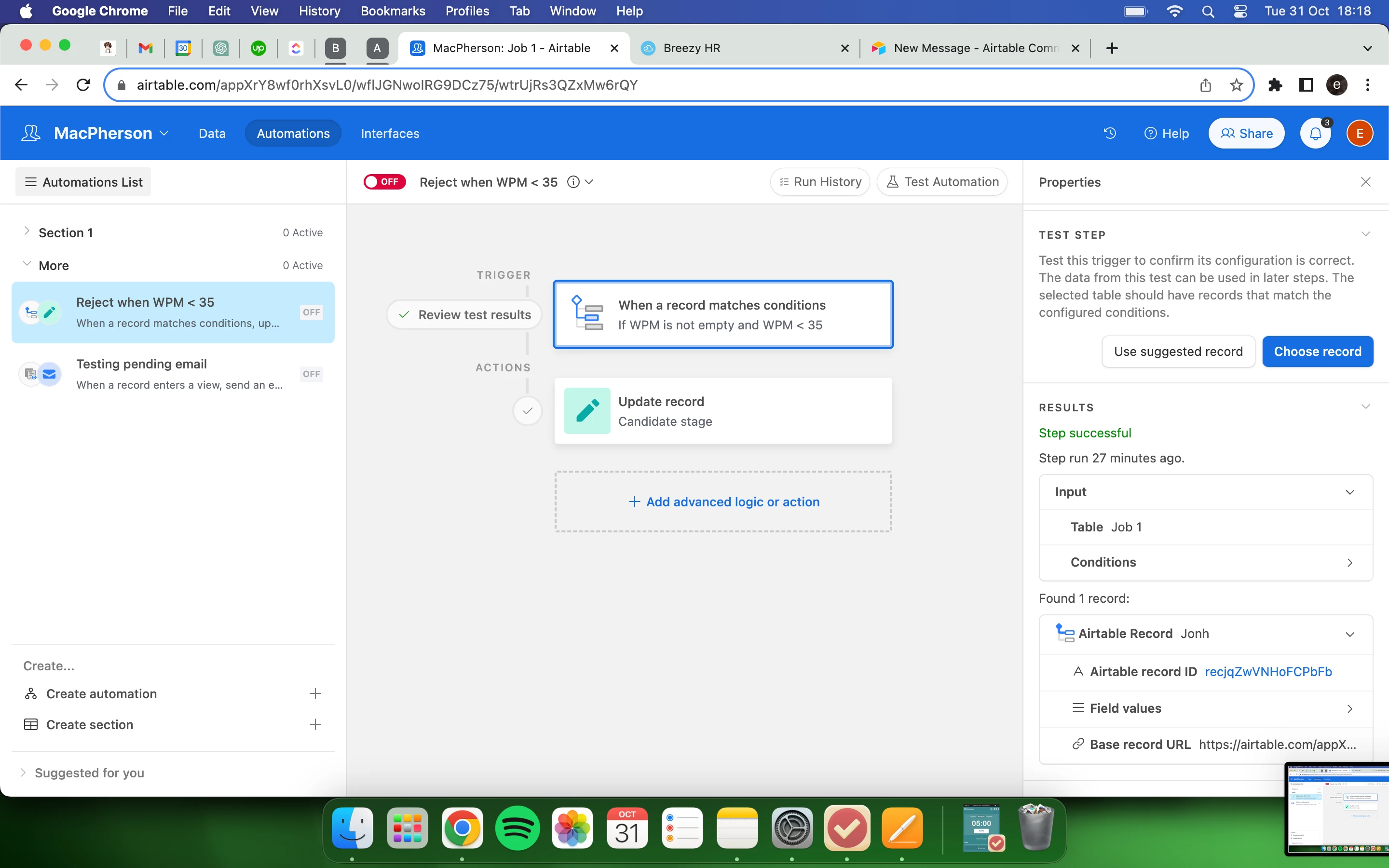

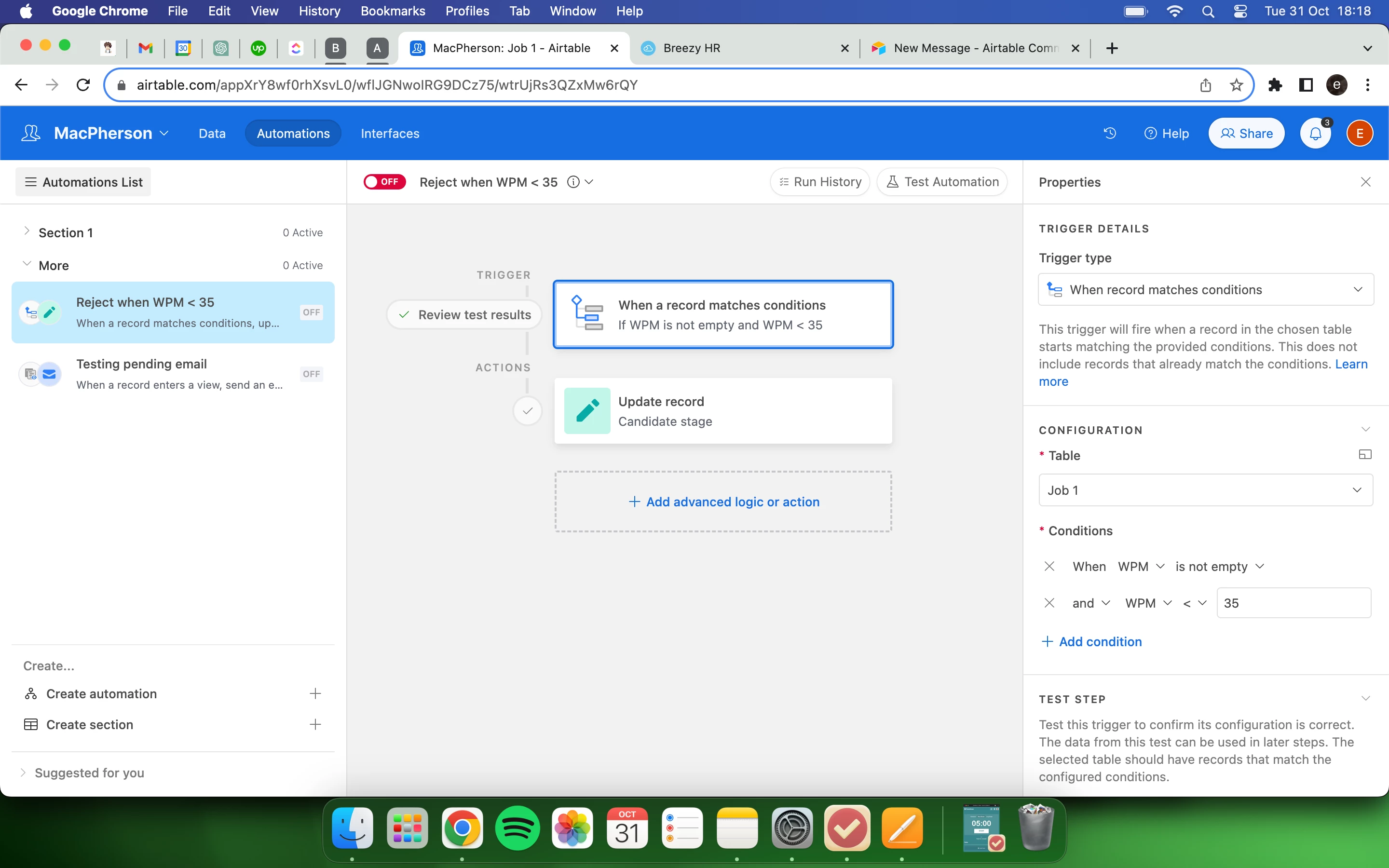

Hey! Thanks in advance for the help
This is my problem, and I know how basic it sounds but I haven't been able to get this done!
I'm creating an automation and Im setting it up so when a record matches a condition (WPM (numbers column) is not empty AND is less (<) than 35) updates a record (Candidate stage (simple selection) to --> Rejected)
But what it does is its sending all numbers (less, equal, higher) to Rejected except when WPM is empty (at least that worked) I've troubleshoot as a maniac and nothing seems to work out - Any idea?

Hey @EdAirtable ! Don't worry it's not just you, happened to me too when I tried to replicated your situation. Luckily I've got a couple solutions for you that I lay out step by step in this Loom Video.
In essence Airtable is 'too fast' and when you type '50' it registers the 5 first which is less than 35 and triggers the automation (crazy right?)
Essentially you've got 2 choices.
If the data is copy/pasted into the cell from a form or an automation, you're fine, the automation will work as expected (try it).
However if the data is entered manually I recommend you add a new check box field called something like 'Ready To Run?', and add as another condition to your automation that the check box needs to be checked to trigger.
Let me know if that all makes sense !

Yes, it's a well-known issue. Also, if WPM expected to be at least 2-digit, you can add WPM>9 to conditions. But if it can be 100, 110 ... , it won't solve the problem, as it will run with 10 , 11 input data values
