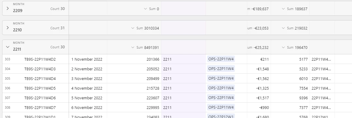

  • April 24, 2023
What about resetting the Running Total to 0 for each grouped record set? I have a list of daily records and I am looking at having a Running Totals per month. I have created a field that pulls the year and the number of the month so it  can be used as a parameter on an iteration for month+1 to return running totals back to 0. Could anyone help with this?
I guess this is another type of filtering....
let table = base.getTable("TB9S") let view = table.getView("Period View") let result = await view.selectRecordsAsync({fields: ["Total Sales", "Running total", "Month"]}) let runningTotal = 0 const updates = [] result.records.forEach(record => { runningTotal += record.getCellValue("Total Sales") if (record.getCellValue("Running total") !== runningTotal) updates.push({ id: record.id, fields: { "Running total": runningTotal } }) }) while (updates.length) await table.updateRecordsAsync(updates.splice(0, 50))

Hey @Bachko!
Since it seems you're trying to get reporting numbers for monthly performance, I would recommend that you actually create a Months table, where each record corresponds to a unique calendar month.
From there, you would link your records in your TB9S table to their corresponding month record.
To get your consolidated reporting metrics, you would use rollups and formulas on the month object.
Once it's all together, it's quite intuitive and it works incredibly well.
Scripting this type of operation is redundant and more work than it's worth.
