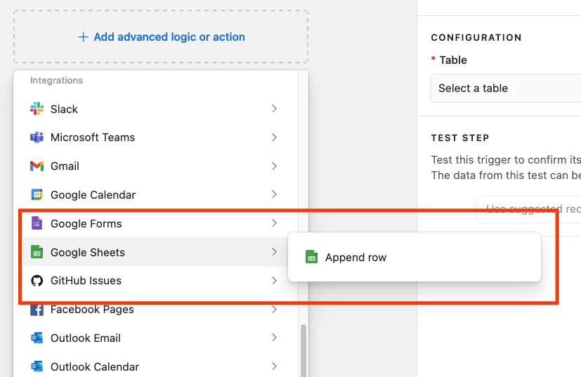

Hello there, I would like to know how make an automation of daily record updates to the Spreadsheet? I've read some posts in this forum and all of them were asking to use a third party which needs to pay more again. How to do it just in airtable?

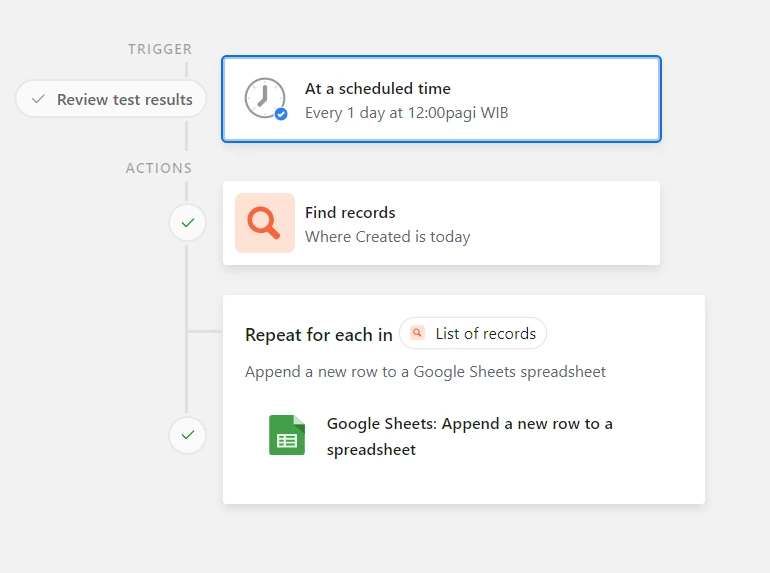

If you're using Google Sheets, the "Append Row" action should work for what you need?
You'd create an automation that triggers at the end of the day and use a 'Find Record' action to look for all the records created on that day.  You'd then use a repeating group on the results of that list and you could then use 'Append row' action in that repeating group
  • Jun 28, 2024 1:27 PM UTC
Yes! thank you so much it works!
