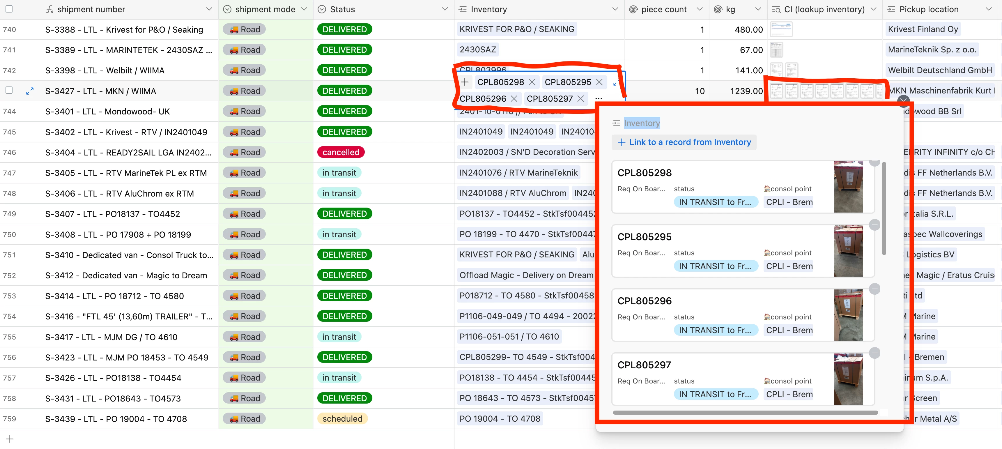

Thank you so much for your message. Maybe I can show you an example to underline my situation. See attached screenshot showing my list of transports (shipments table) with the items included from my inventory table.
Now, the transport includes 10 pallets covered by the same commercial invoice. Consequently the "CI (lookup inventory)" pulls 10 times the same invoice because every pallet line is having the same CI attached individually.
When I want to send a shipment information by automation there is 10 times the same invoice attached. Somehow I need to tell airtable to ignore duplicate filenames. Maybe I am completely on the wrong path...And I don't see an approach by using Make.
Kai
