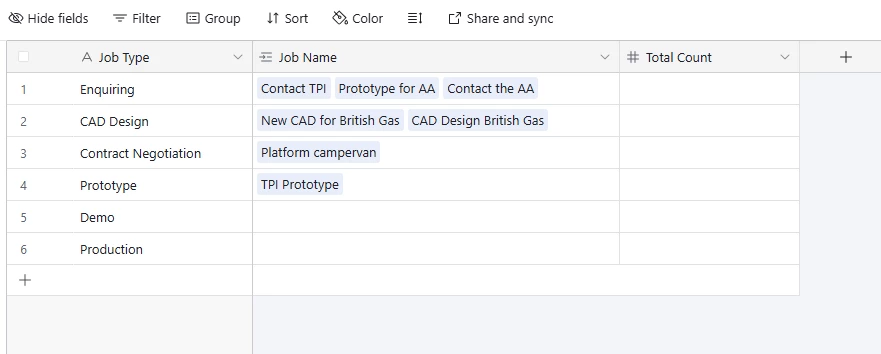

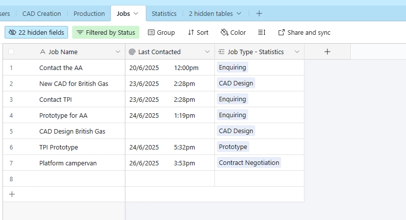

I want to be able to count the total amount of times all “jobs” has had all “job type”.
Example: Job - “Contact Customer” is Job Type - “Enquiring”. If we get a hit the type will change from “enquiring” to “prototype” however I want to log that is was an enquiry permanently and count how many total “enquiring” we have had. Then I will be able to track on a graph how many “enquiring” has converted into sales or failures.
Here are my two linked tables. I have set up previously a counter to +1 every time the record “enquiring” had updated however my problem lies with when the job changed type it will still +1 on removal also.
Basically I want “If records is added, +1 to total”
thanks for any help in advance

Hi ​@ScottWorld, thanks for the reply.
I have tried the count field but that is not good. Once something has moved to a different job type then the count lowers again. I only want the number to go up when items are added and as they move on the value stays

Hey ​@Mondays,
I would actually suggest having a different schema, by creating a table called Events (junction table) to keep a 1:1 relationship between Job and Job Type.
At a Job level, you could always lookup the Last record from Job Type you have linked through the Events table (to get the exact info you currently have).
Also at a Job level, you can have a count field -more on count fields here. Regardless of Type changing through the Events table, your count field will only go up.
Best thing: You get super precise and granular data on the log of events (changes in type).
-otherwise, you can still achieve what you are looking for. My suggestion would be to have an automation built with a script that will do a +1 to a number type field each time Type gets updated/is not blank.

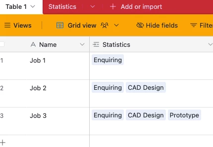

Hm, given that the ‘Statistics’ link only is needed to get you those numbers, what if you just kept adding to that field whenever the Job progressed instead of replacing the previous entry?
