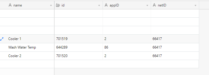

It shows up in airtable this way:
For each of these sensors, I would like to create a new record with the name of the sensor and the temperature. Any help would be appreciated.

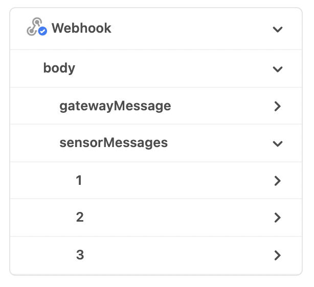

I don’t know JavaScript either. I did try make.con but it only works with the first record, it doesn’t keep going with the others. Perhaps there’s a setting in missing?
  • September 16, 2022
Make definitely works with all the records. You may need to use the Parse JSON tool or the Iterator tool to help you get all the records.

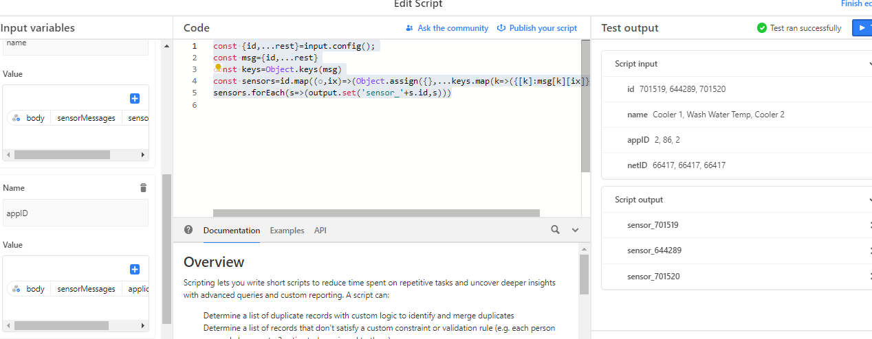

it’s a tricky task for first time, but last weeks I had todo a lot of table ‘rotations’, so it’s not so much code needed
put each value in separate variable, try to not add spaces and extra chars, because then array will be converted to string.
I did for 4 properties, for example, you may add all or choose any you want and even no need to change code.
You can use output variables to create records at next step. I mean, 3 next create record steps ))
Source:
const {id,...rest}=input.config();
const msg={id,...rest}
const keys=Object.keys(msg)
const sensors=id.map((o,ix)=>(Object.assign({},...keys.map(k=>({[k]:msg[k][ix]})))))
sensors.forEach(s=>(output.set('sensor_'+s.id,s)))

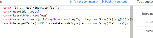

or, you can match variable names with field names, and if fields are simple text, substitute last line (sensors.foreach...) by write command, and put it to table:
await base.getTable('NAME').createRecordsAsync(sensors.map(s=>({fields:s})))
I was able to get it done with the parse json tool and the iterator.

Thank you for the help. I was able to get it done with make, but I’m going to try scripting as well since the native solution would be the most robust.
  • September 17, 2022
That’s great to hear! Make is the best! :grinning_face_with_big_eyes:
