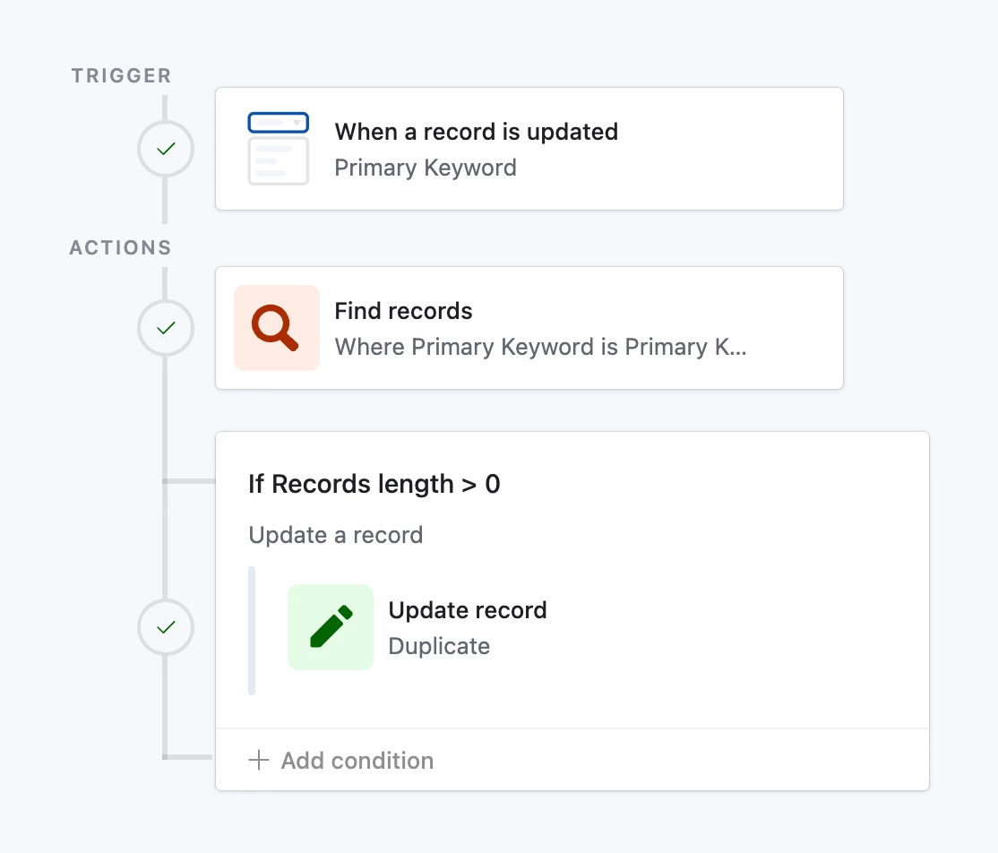

Hi Imee!  Yeap, you could set up an automation that'll trigger whenever a new record gets created, and it'll look in your table for any records with the same address.  If it finds any records with the same address it'll tag the triggering record as a duplicate, and your automation would look something like this:

Hello, @TheTimeSavingCo thank you for this, but when I tried setting it up based on your linked base.
It would tag all of the recorded entries as duplicates even if it's not.

Ah you're right, so sorry, it's missing a condition where it checks whether the record ID is the same.  I've updated the automation in the linked table and it should work now:

When creating a new Record the field is empty so the workflow will not work! You need to change trigger to “When record gets updated” and set view and correct field. With this it will work 100% every time.
