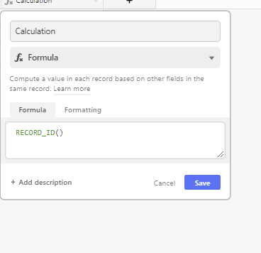

@Martin_Leber - writing the whole thing may be pushing my time on the community board a bit far - but as a help
you can get the app and interface stuff from the url (simply cut and paste form your record picker interface and delete the record part)
then create a field with the record ID as below…
then another field that is a formula that concatenates the interface url with the record id - which you surfaced as the pic
then use this url in the text of the autogenerated email
I hope they are grateful :winking_face:

Seems like this could work - now i have to figure out how to read the appte-number, the pag-number and the rec-number and somhow connect all 3 together to create a link for all the different tables and records. :slightly_smiling_face:
