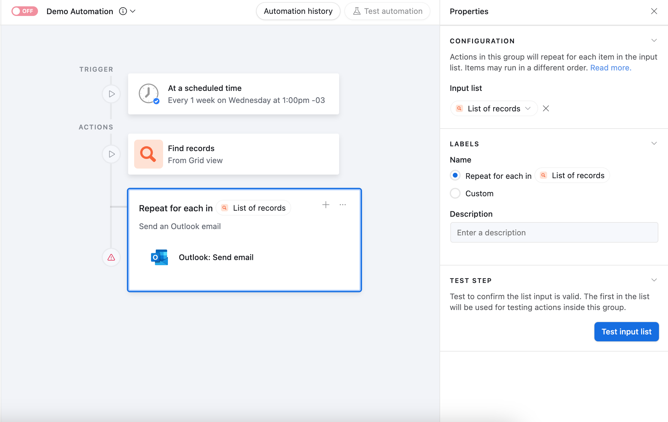

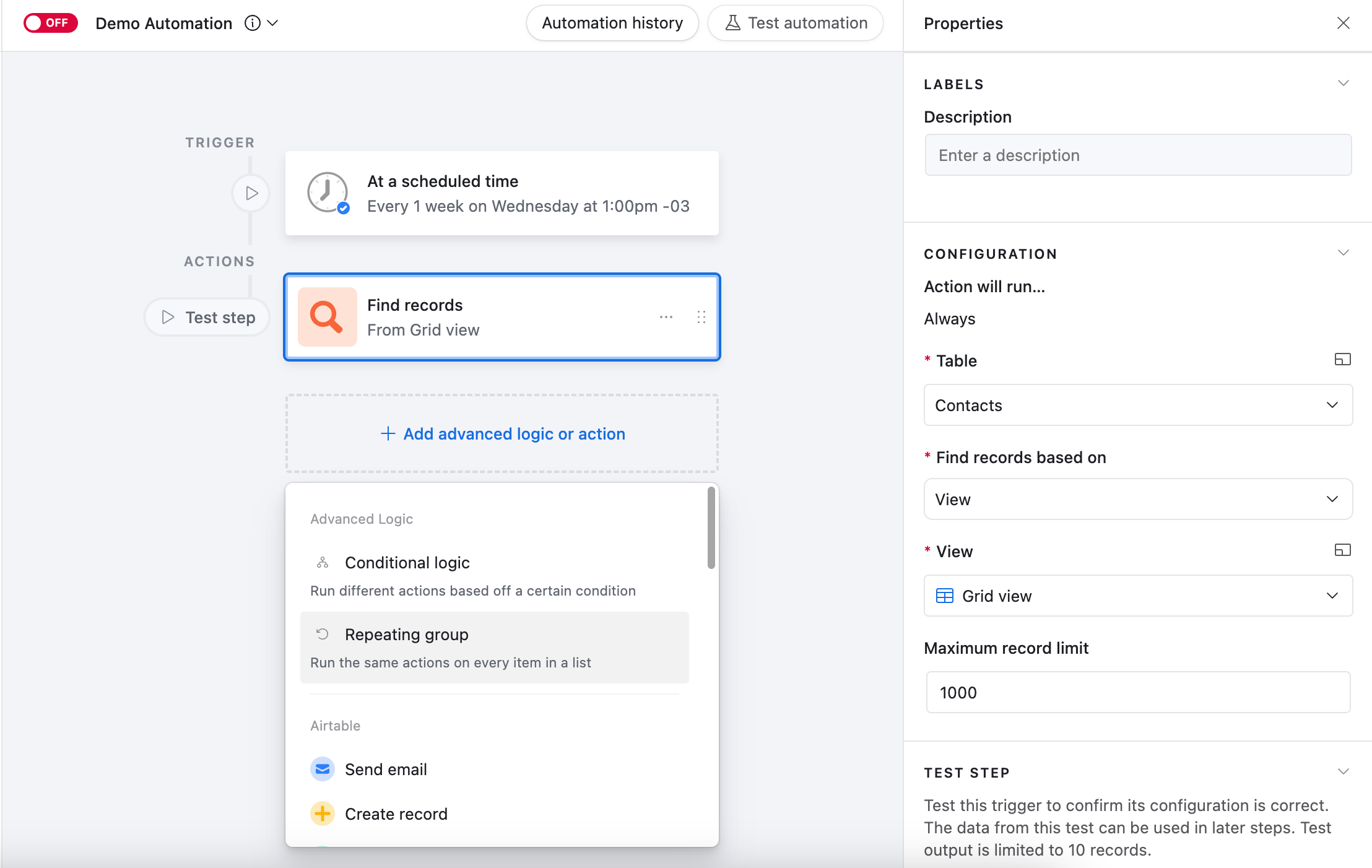

Hey @jul14nm0r3n0!
Following with @ScottWorld's answer above, below please find a step by step guide.
1. Create Automation, and set the trigger to be of type "At a scheduled time..."
2. Below your trigger, create a new Action to "Find records". Select your table, and under "Find records based on" select View and your specific corresponding View.

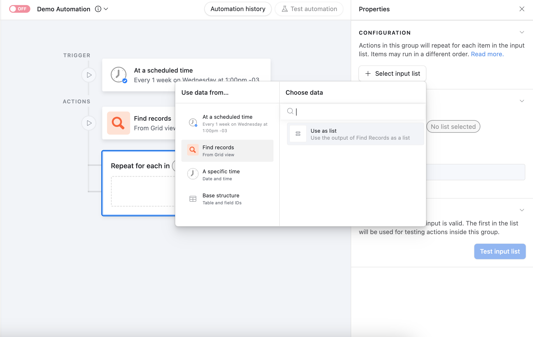

3. Then create a "Repeating Group".
4.  For the Repeating Group's input list, use the output of the Find Record action -see below.

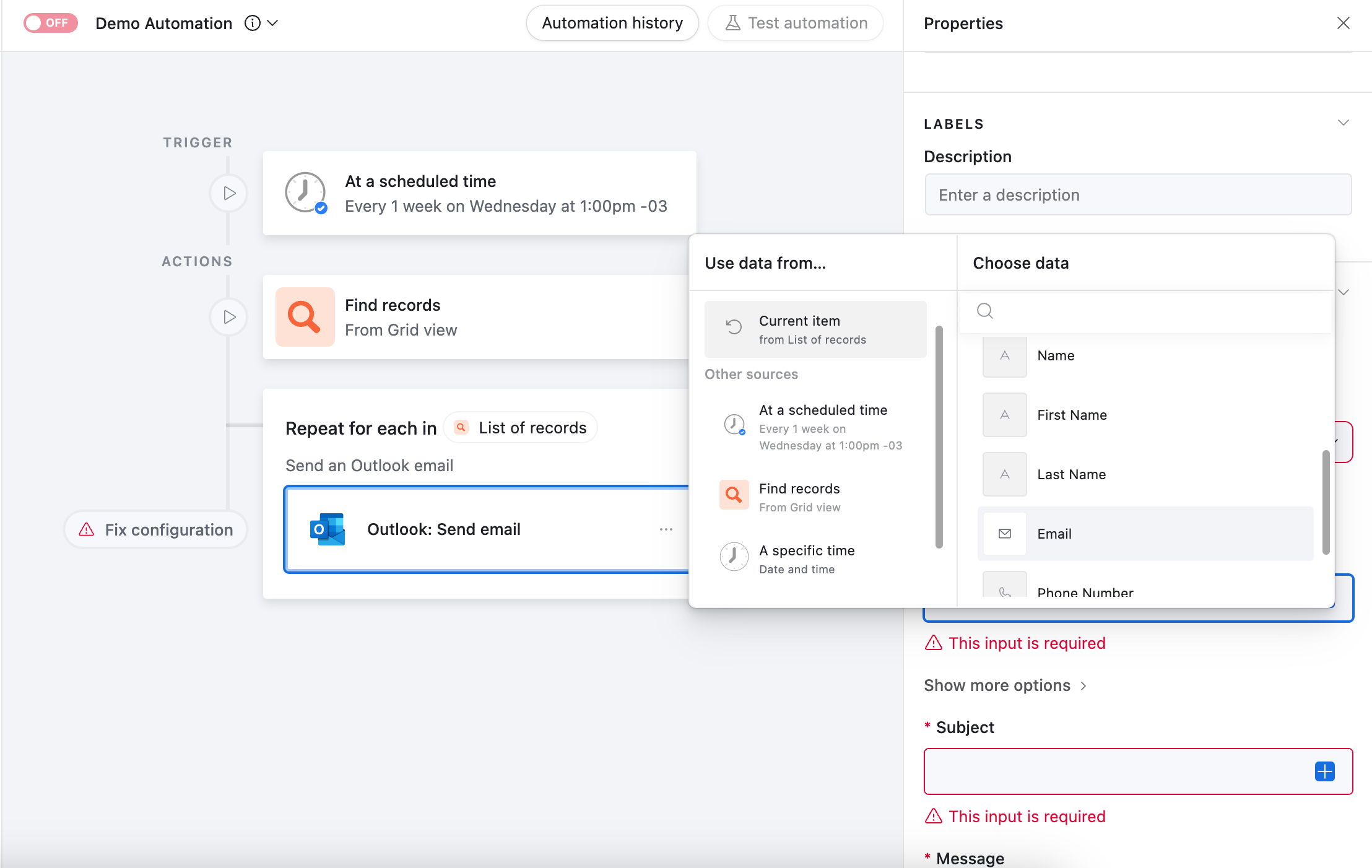

5. For last, create a "Send Outlook" action within your repeating group, and under "To:" field select the email from the "Current Item from list of records".
Below you can find the full automation!

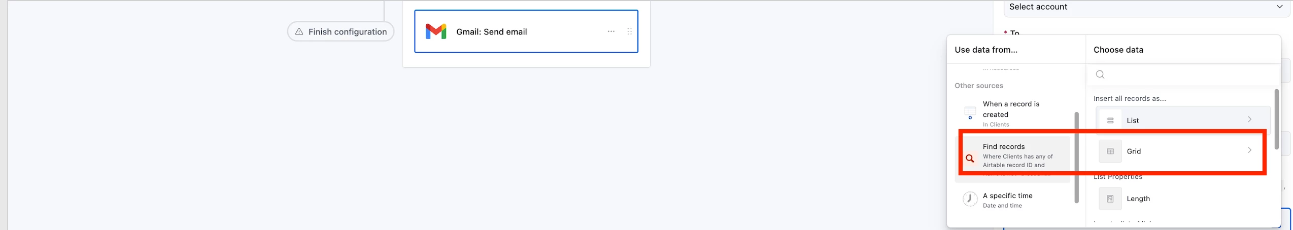

This is very helpful, thank you. Is there a way to reference the record in the email and\or provide a link to it? Honestly, just getting a list in the email would be great so I’d know what to look for.
Basically, can I somehow include the “Found Records” table in the email?
Thank you.
Yes ​@fwall, you can absolutely do that.
You can include a grid view of the found records and/or the url of such records. -see image below.
