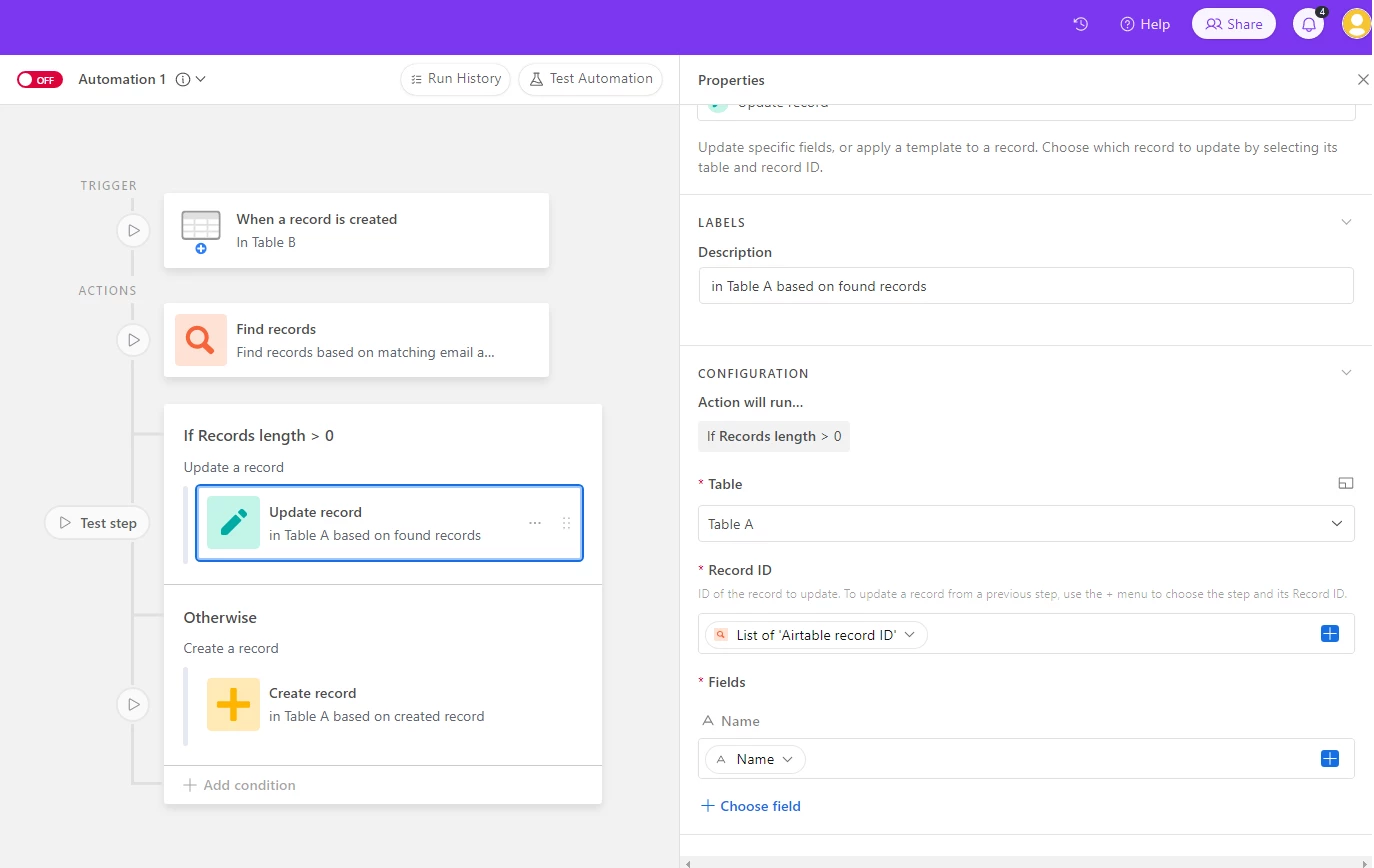

In terms of information flow, the ideal would be, when a record is created in Table B, take the info from field X in Table B and Update Field X in Table A in the record that matches the same email in Table B.
Got it. We're getting closer, just need to add a few things... 🙂
The Find Records step is the same as above, but for Table A now.
The next step is a conditional action that says if any records are found by the Find Records action, then update the found record in Table A. If no records are found, then create a record in Table A. You can populate fields from Table B's trigger record in Table A this way.

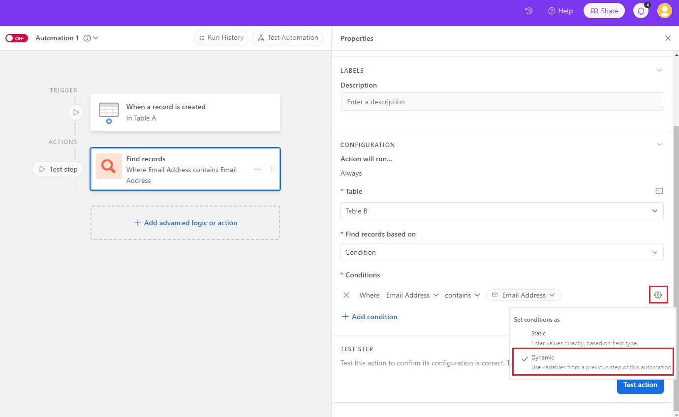

You can use a Find Records action to lookup records in Table B based on a value in your trigger record/Table A.

 Hi Stephen, tks for reaching out so fast. The problem is that is not a fixed value in Table A, its the email value and they are different across records : /
No problem! I understand what you mean 🙂 You would use the dynamic setting here to use the email address from Table A in your Find Records logic:
