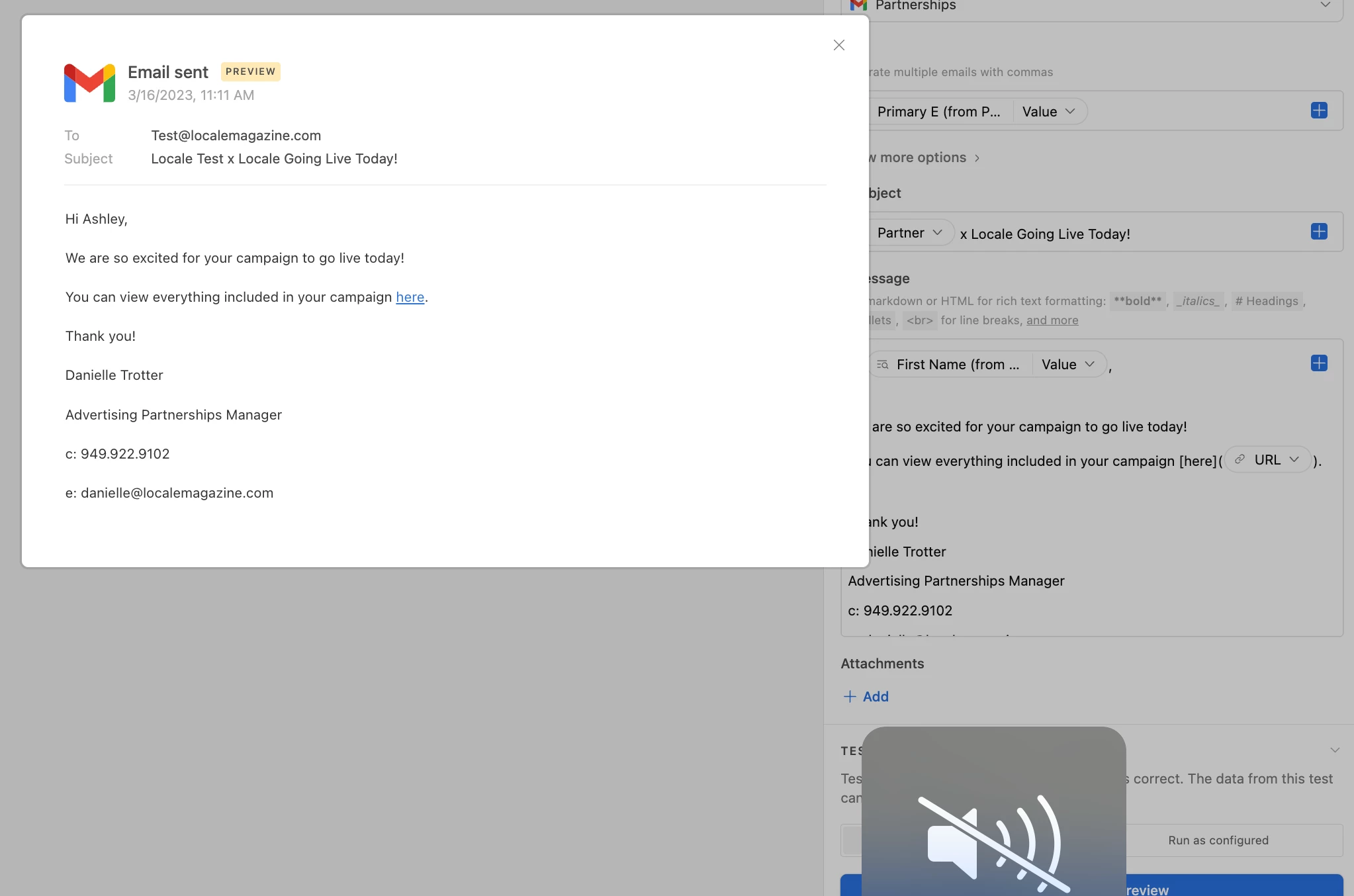

Hi Kuovonne. I’m sorry, I don’t understand. I don’t have a static URL; I want my email automation to use whatever URL is in the URL field for a given record and send that as a hyperlink in the email. How do I apply this, please?
  • Oct 28, 2021 2:51 PM UTC
When you compose your email in the automation, include the field with the url inside the parentheses for the url.

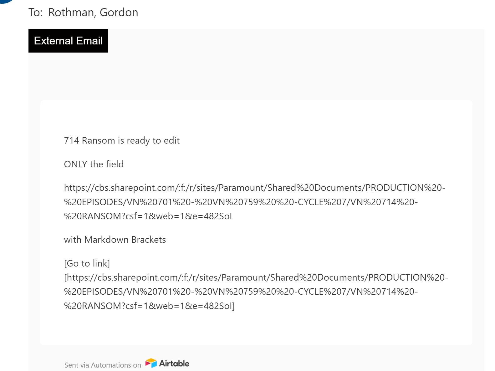

These should be snapshots of the Automation Action field, the URL field in the base, and the email received when triggered. I tried it with and without the Markdown syntax. Thanks for your help!

Markdown is different than HTML. It is formatted like this:
[Click on this link to go to Apple’s website](https://www.apple.com)

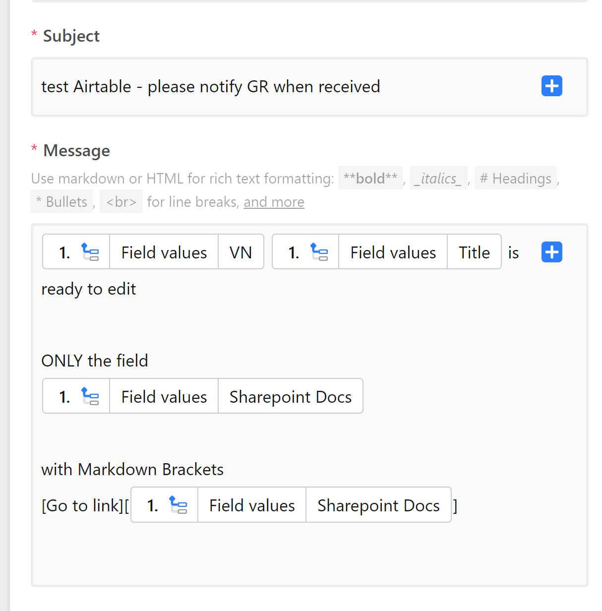

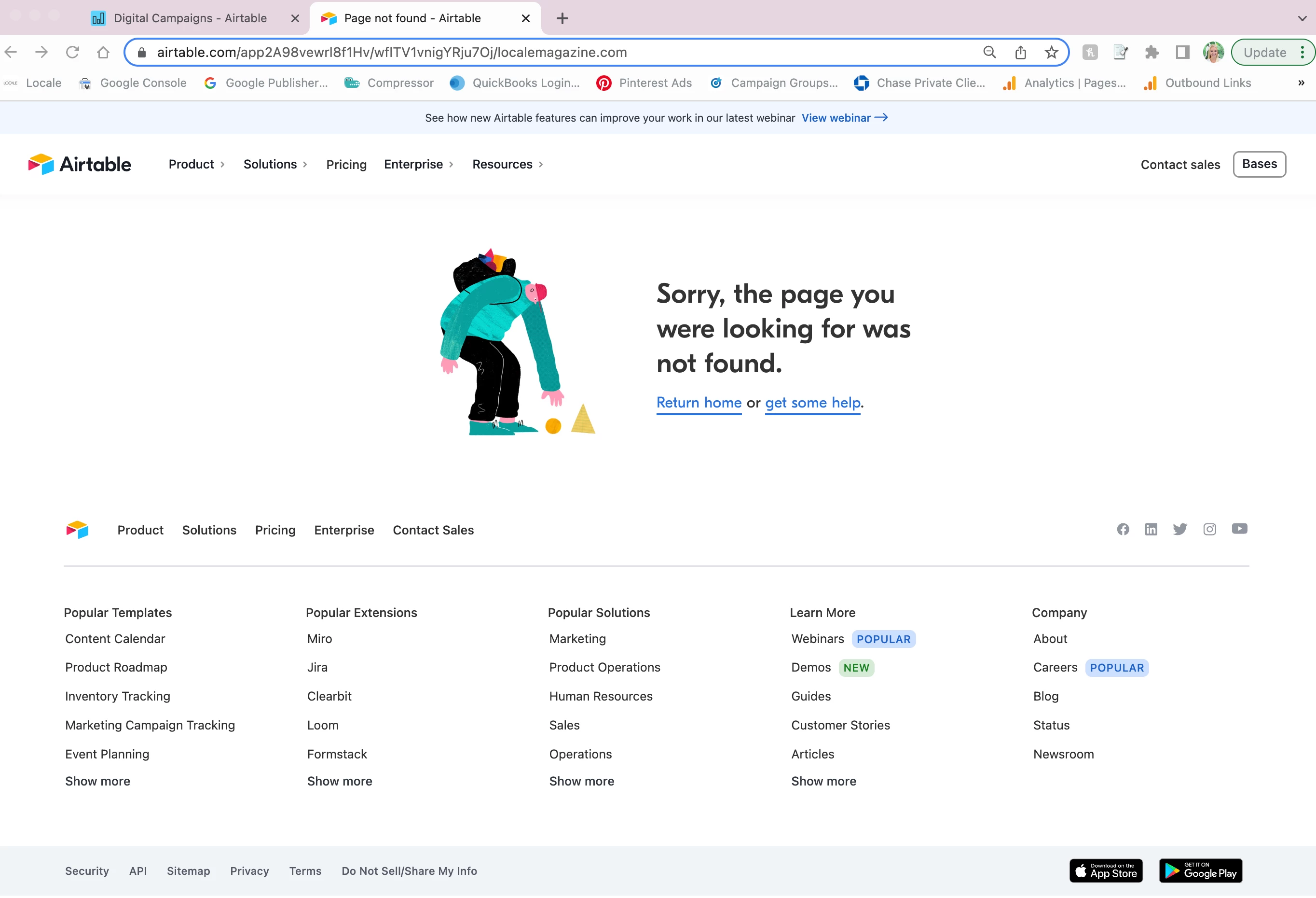

I've tried this, but when I click on the URL in the email preview it brings me to a broken airtable site, instead of the actual URL...
FPX
Forum|alt.badge.img+12
  • Sep 26, 2024 10:25 AM UTC
@ScottWorld @kuovonne

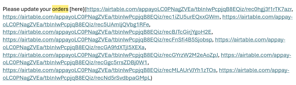

Any idea what I am doing wrong? I cant seem to shorten the hyperlink. I am using outlook email
  • Sep 26, 2024 9:38 PM UTC

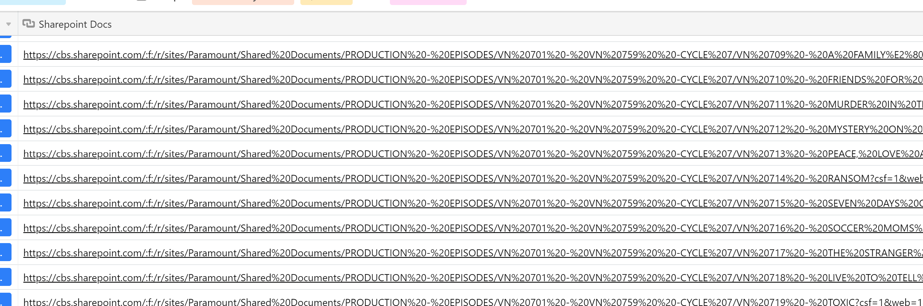

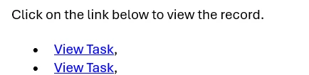

FPX, You are including a list of URLs, not a single URL. The syntax for a markdown link only works with a single URL. See this thread for more info.

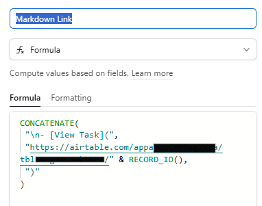

@kuovonne - Thanks for this. I seem to be missing something...Can you please see why nothing is populating below?
  • Sep 27, 2024 11:28 PM UTC
I don't see any issues with your formula field. Does the formula field show a value in a data grid view?
I'm not sure how the second screen shot relates. In order to use the formula field, you need to include a list of field values for the formula field, not a list of records. You may also need to retest the automation, starting from the trigger, to get values to show up.

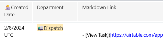

Thanks Kuovonne, i wasnt doing the list of field values so is populating now as per below screenshot.
However, the above is no use for me without the link referencing the information against each columns so how would I make the formula work within the grid view please? See below
